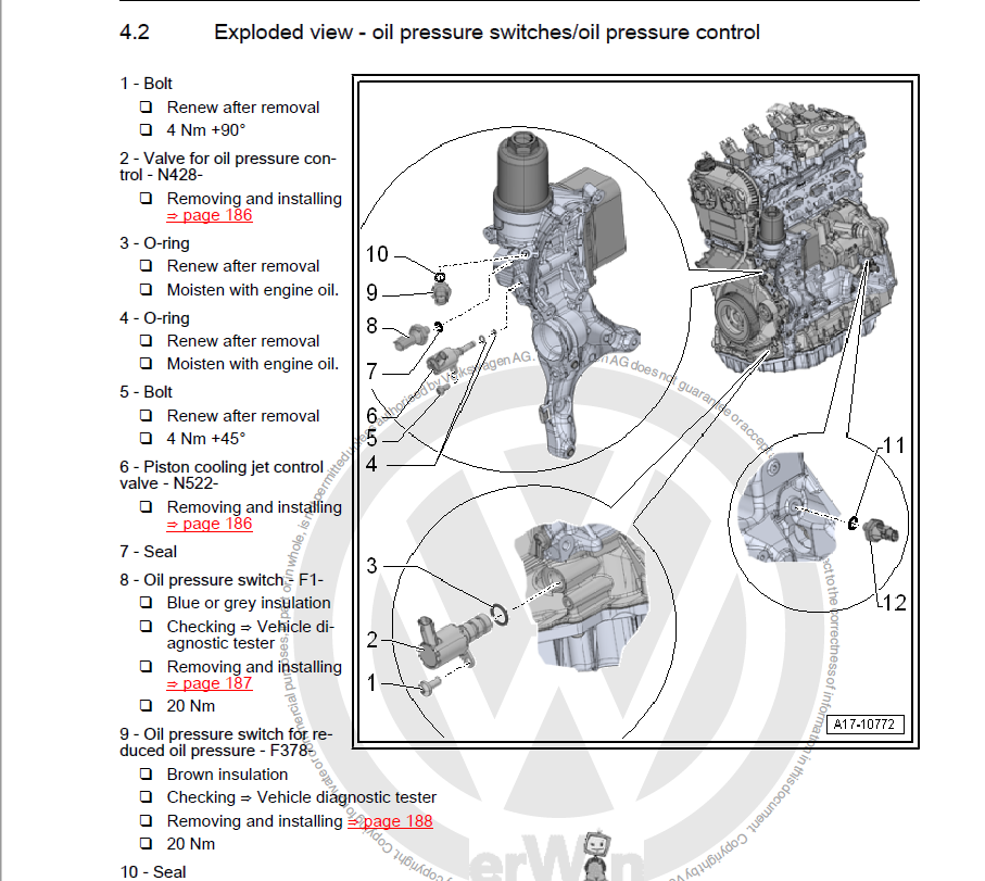

  10. This might help possibly quite a lot explain what I was referring to. So, from my review of service diagram. It indicates. 2 x oil pressure switches in oil filter housing bracket 1 low pressure, 1 high pressure 1x spray nozzle valve solenoid in oil filter bracket 1 main oil pressure control valve in lower engine near crank pulley. 1 extra "level 3" oil pressure switch on front face of engine to right of water pump. I didn't know about that one.

  14. Isn't this regulated by a control solenoid in the oil filter bracket. It's not a sensor (there are also 2 x oil pressure high and low sensors in there as well). Have you definitely replaced the control solenoid? What was the part number. This issue with the oil pressure sensor fault make it sound like it might be contaminant debris causing them to block up ...maybe. could also correlate with the engine failures and debris that would of been circulating. Have you replaced the oil pressure sensors?
