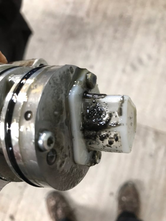

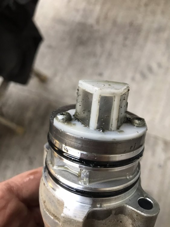

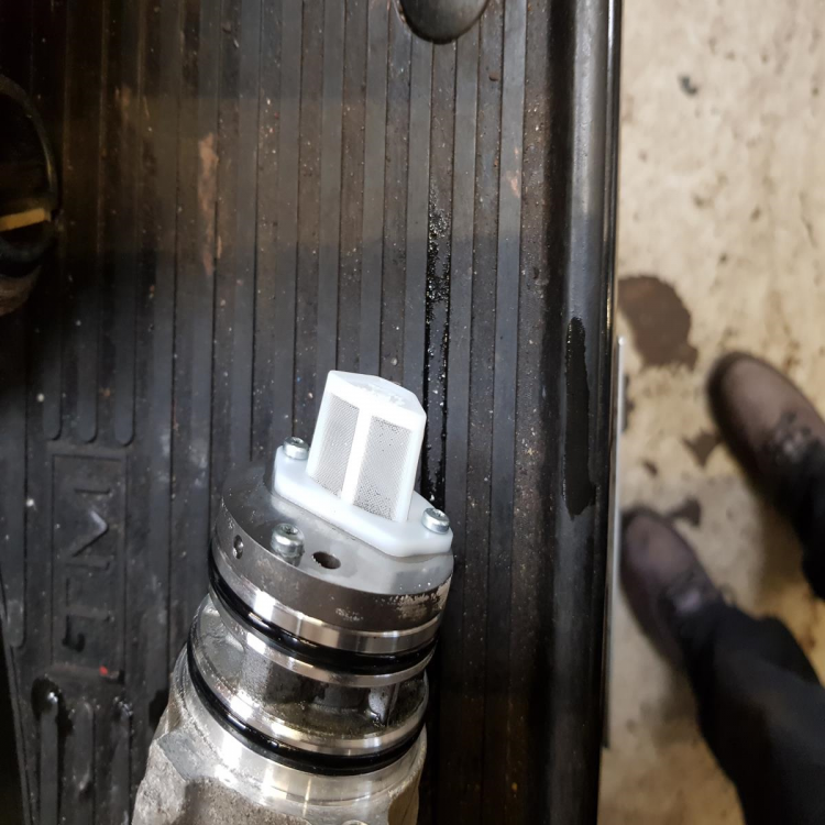

You will need: 5 and 8mm hex keys. Lint free rags. Cotten buds. Torx 10 (need to confirm) . 10mm socket. Flat blade screw driver. Syringe (or use a freezer bag with a hose if you dont

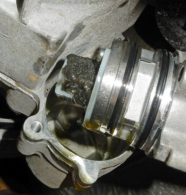

A good guide. I can confirm the filter is secured by 2 torx 10 screws Hope you don’t mind but here’s a couple of pics showing level plug and drain plug from when I done mine.
I’ll contribute with this pic showing Haldex fill point (2) and drain plug (1) Sent from my iPhone using Tapatalk
