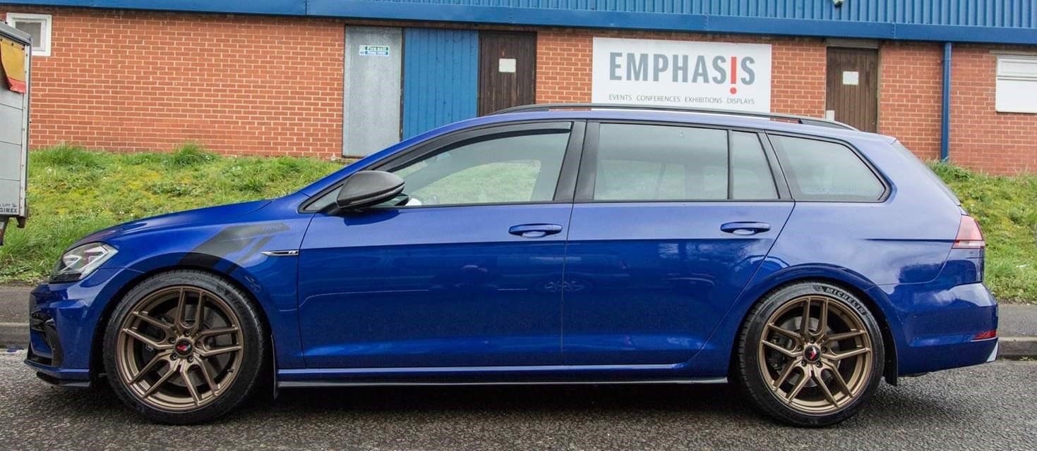

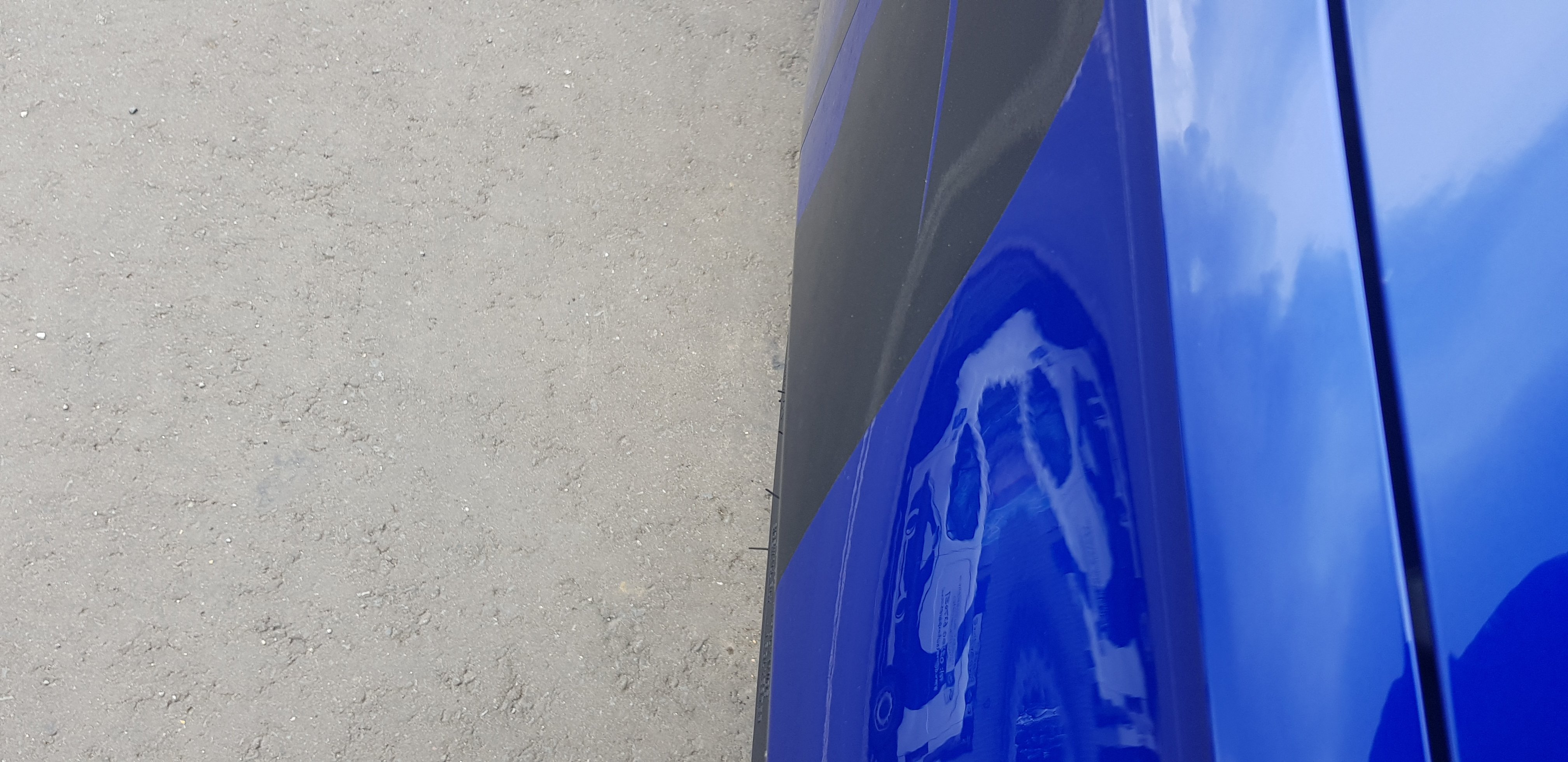

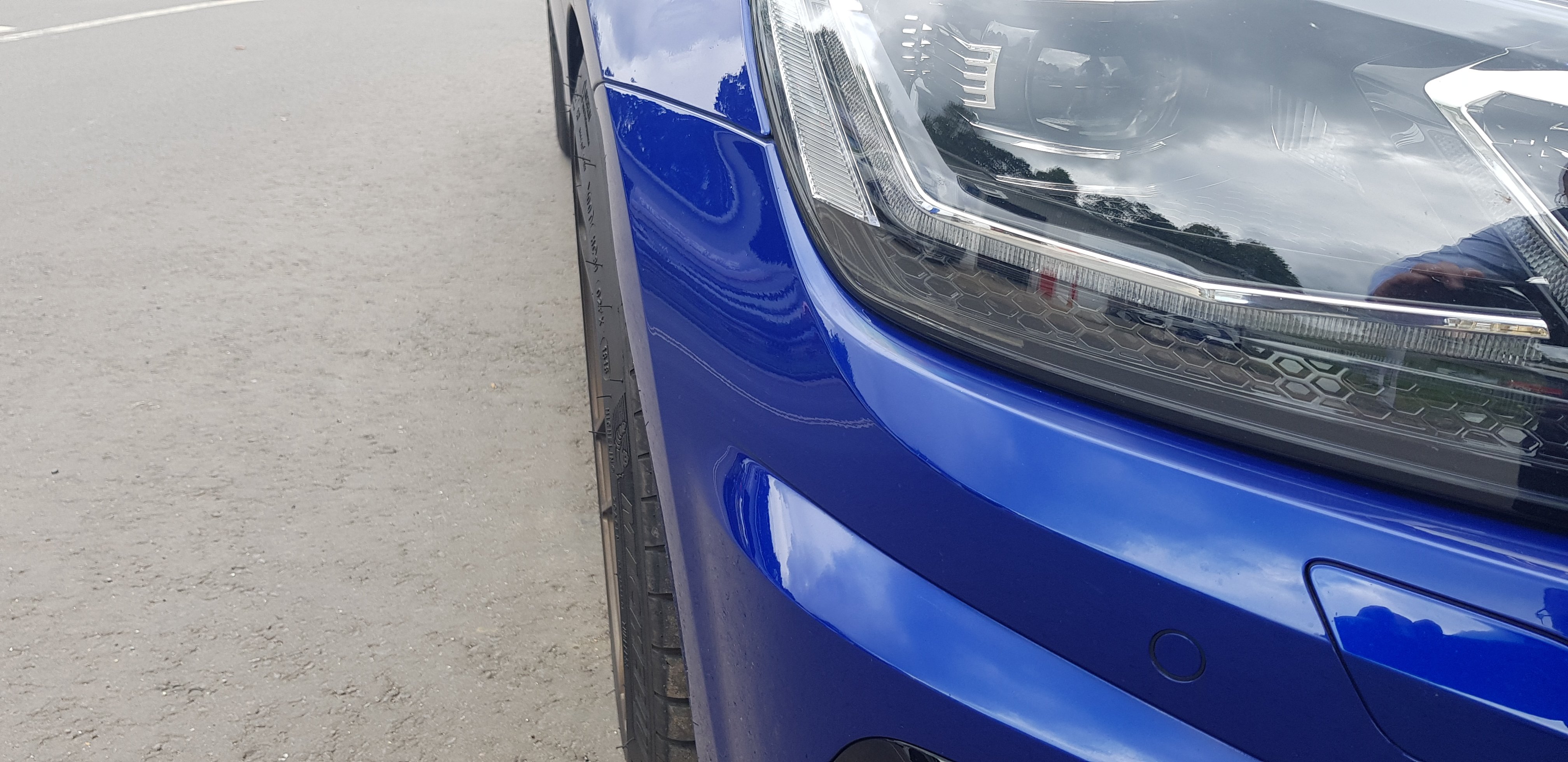

FamousAfroJay Posted June 15, 2019 Report Share Posted June 15, 2019 11 hours ago, Dazzle said: Hi Jay (assumption considering your username ) Do you have pictures of your wheel/tyre setup? Maybe from different angles please? Many thanks, Darren Good guess on the name Darren As I mentioned, sits flush doesn't rub and it got Racing Line springs on. You asked for more pictures... Quote Link to comment Share on other sites More sharing options...
Dazzle Posted June 17, 2019 Report Share Posted June 17, 2019 On 15/06/2019 at 02:55, FamousAfroJay said: Good guess on the name Darren As I mentioned, sits flush doesn't rub and it got Racing Line springs on. You asked for more pictures... Many thanks Jay I've acquired a set of 18's which happen to be the same spec as yours, 8.5 and ET40 so it's great to see some fitted. This means I don't have to worry about getting spacers now I believe? Also, could you put a picture up showing the tire to arch gap now you have the racing line springs fitted please? Quote Link to comment Share on other sites More sharing options...
FamousAfroJay Posted June 18, 2019 Report Share Posted June 18, 2019 17 hours ago, Dazzle said: Many thanks Jay I've acquired a set of 18's which happen to be the same spec as yours, 8.5 and ET40 so it's great to see some fitted. This means I don't have to worry about getting spacers now I believe? Also, could you put a picture up showing the tire to arch gap now you have the racing line springs fitted please? Hi Darren, what style did you go for? I have this full side on picture from a rare occasion that the car was clean. BobbyT 1 Quote Link to comment Share on other sites More sharing options...
