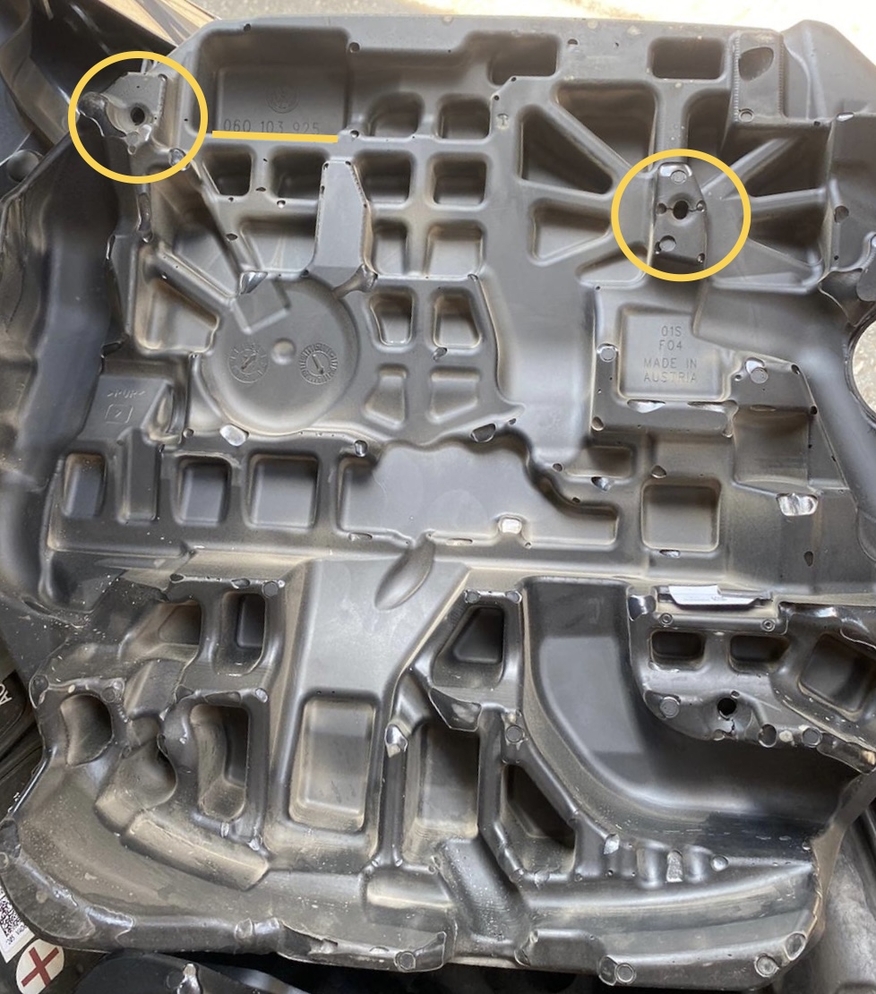

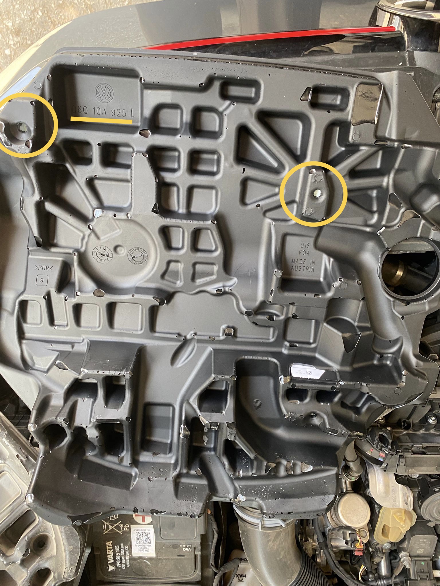

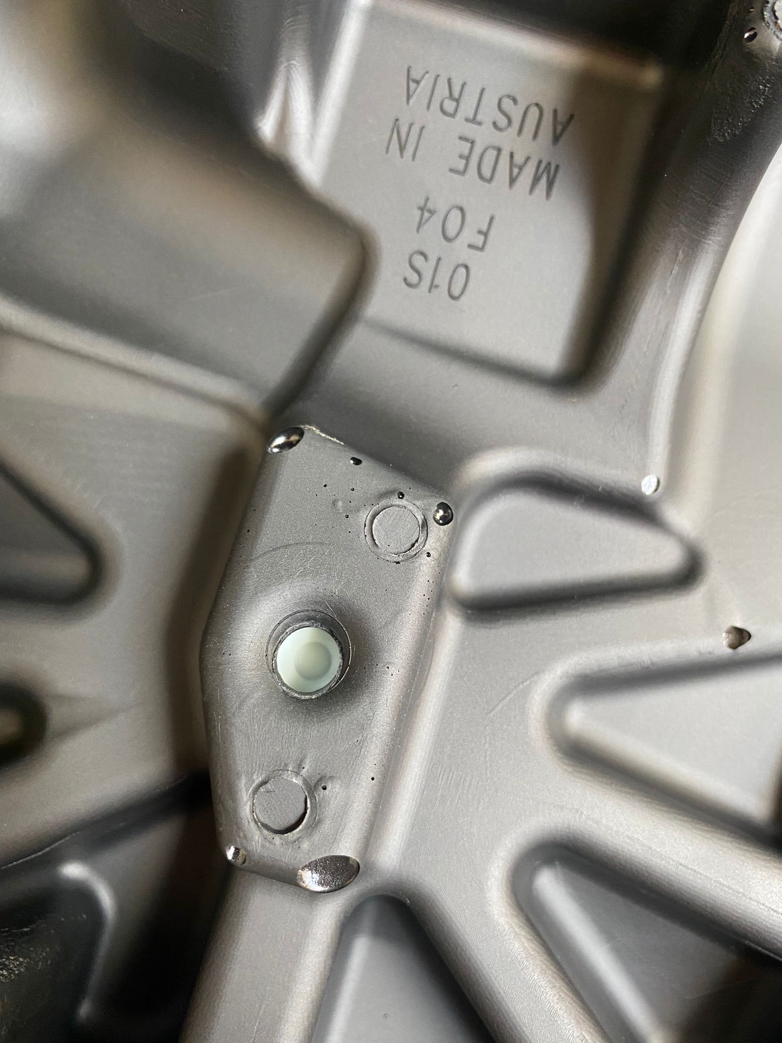

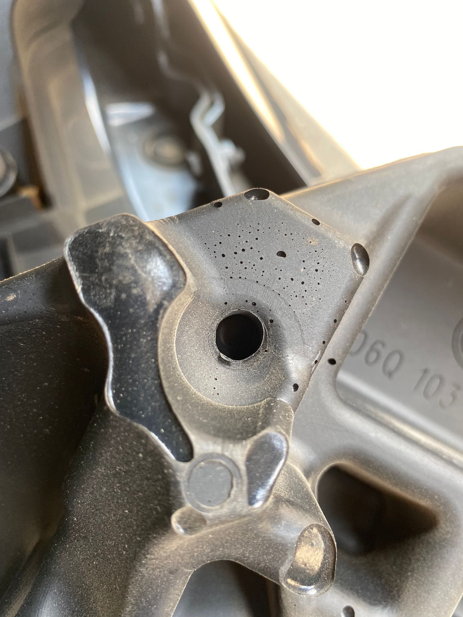

AHG Posted September 9 Report Share Posted September 9 I’d expect the only difference to be in the stud inserts (like the L version) This is the stud recess in the old cover: and this is the rigid insert (in white) in the L version, that the Tiguan and other models had the cover replaced with: When used, in the new one you can here the click of each stud going into the insert, while in the old one there was no audible click since the recesses are soft and therefore they tear up. Quote Link to comment Share on other sites More sharing options...
