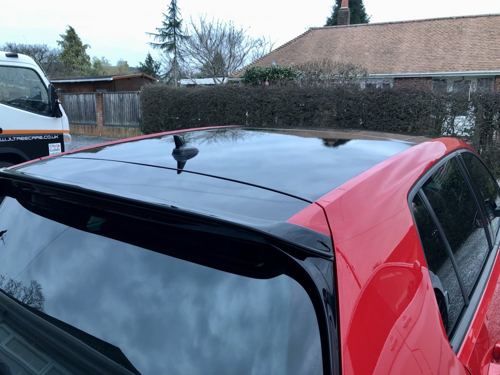

Bodyboarder81 Posted April 26, 2022 Report Share Posted April 26, 2022 I had one of the tcr style ones from aliexpress … could fault it to be honest . Took a couple of weeks to arrive but was packaged well and fitted 100% spot on . Unfortunately for me it was a little too subtle , so removed it and put a oem + from maxton on . Everyone thinks it’s a genuine VW item still , helped by the gloss roof to tie into the pan roof Adam7.5R 1 Quote Link to comment Share on other sites More sharing options...

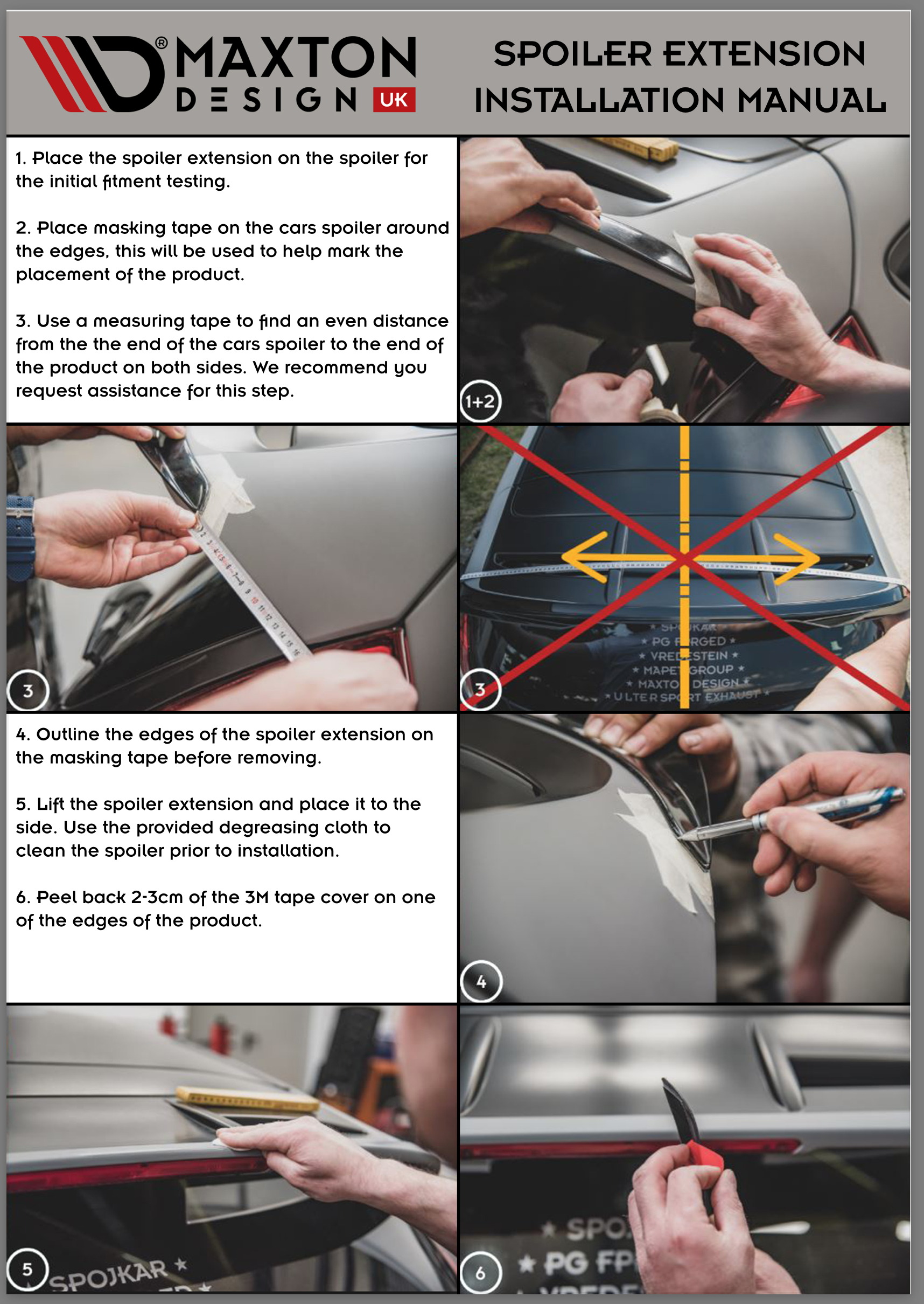

OrxyR Posted April 26, 2022 Author Report Share Posted April 26, 2022 Looks awesome! At this rate I'll never order one! This guide will be useful for me so sharing in case of use for others https://www.maxtondesign.co.uk/pdf/cap-spoiler_fitting-manual-maxton.pdf bneh and theskivingscholar 2 Quote Link to comment Share on other sites More sharing options...
Adam7.5R Posted January 9 Report Share Posted January 9 On 26/04/2022 at 15:21, Bodyboarder81 said: I had one of the tcr style ones from aliexpress … could fault it to be honest . Took a couple of weeks to arrive but was packaged well and fitted 100% spot on . Unfortunately for me it was a little too subtle , so removed it and put a oem + from maxton on . Everyone thinks it’s a genuine VW item still , helped by the gloss roof to tie into the pan roof That looks mega! Do you have a link you could share? I've been weighing up the TCR style one vs Maxton & think I'm sold on the Maxton after that. Quote Link to comment Share on other sites More sharing options...
