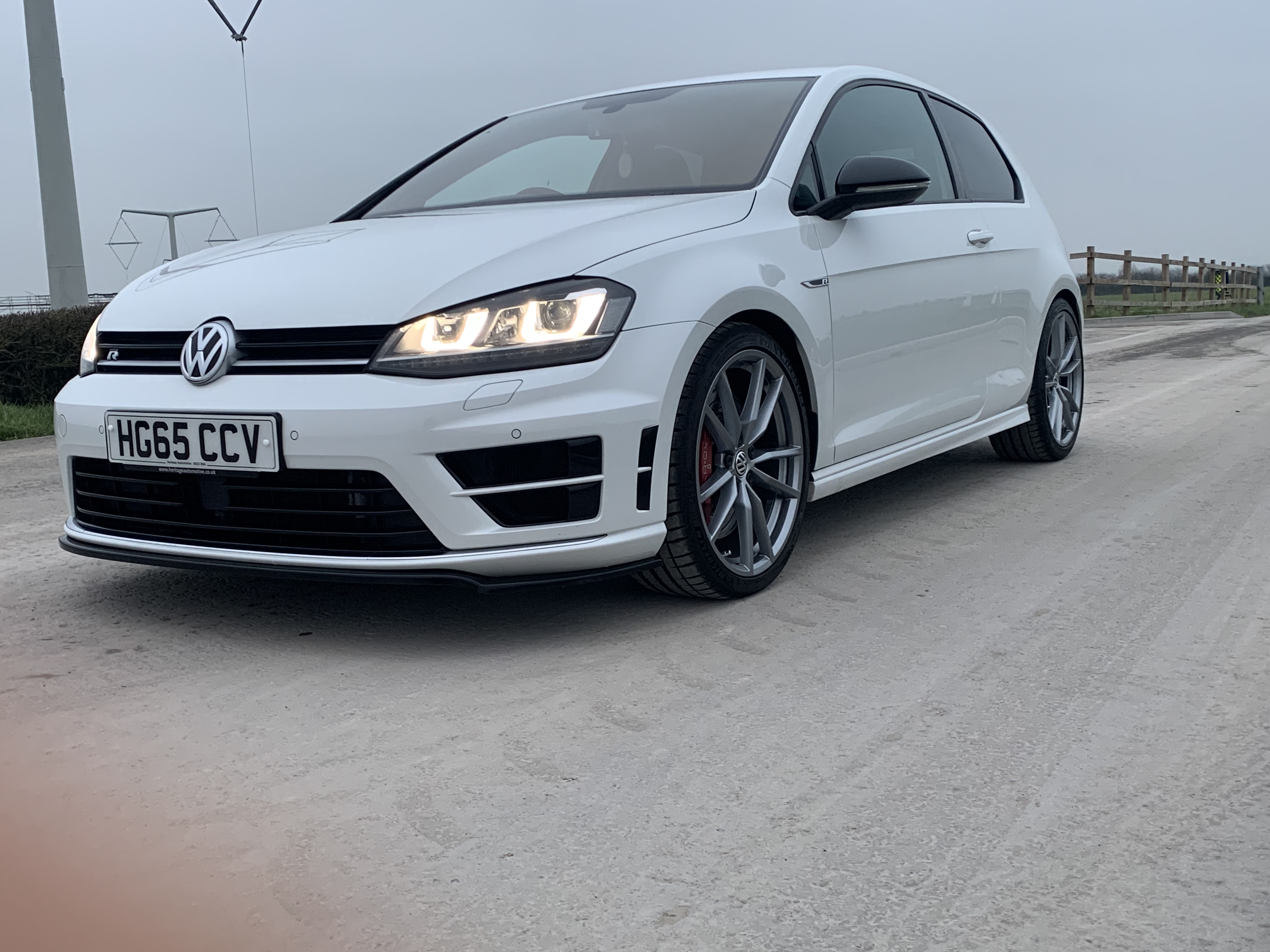

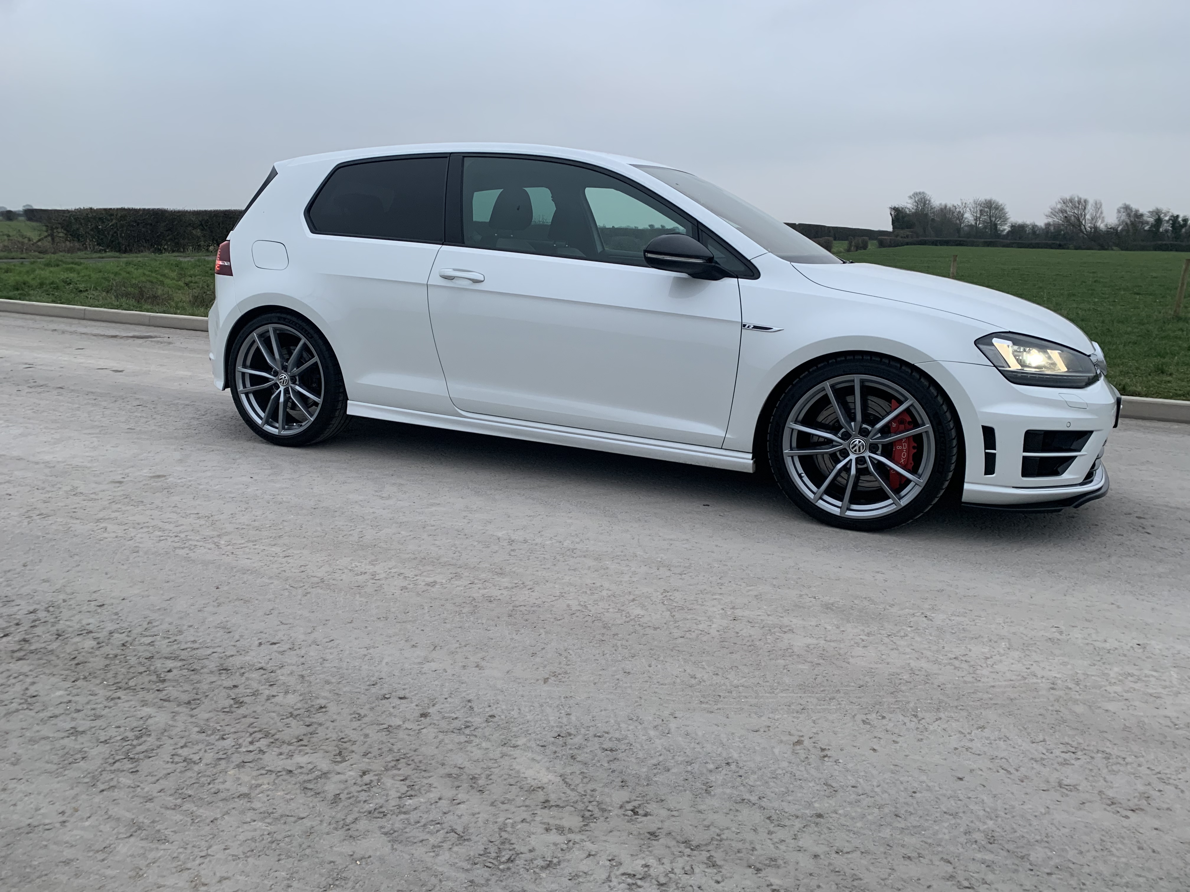

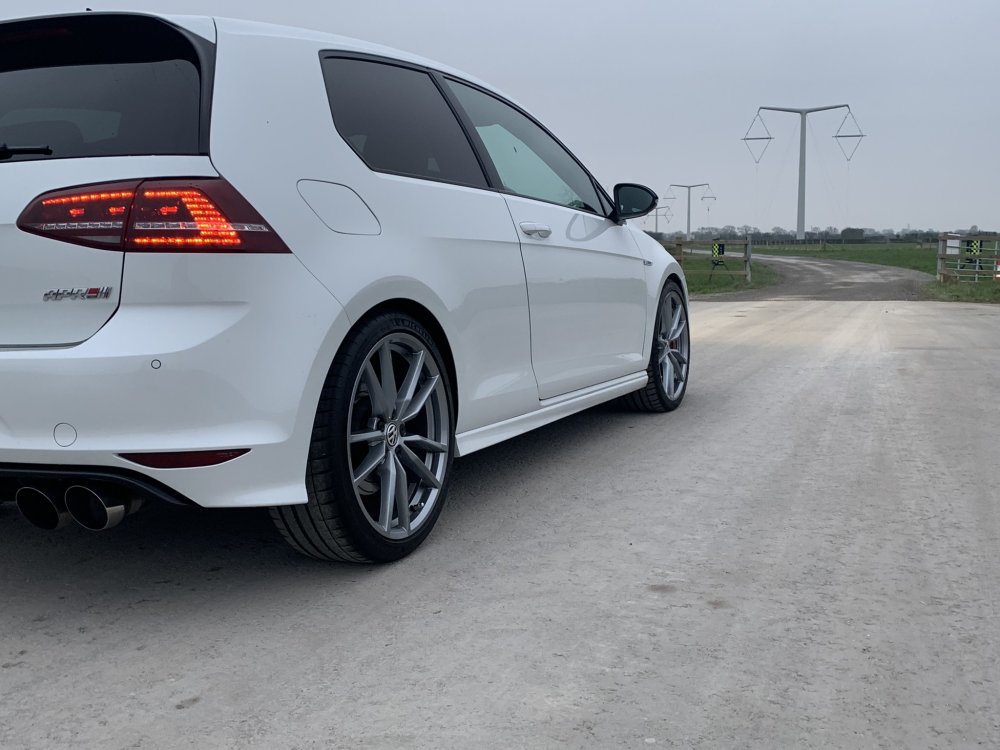

scoobyc Posted February 18, 2023 Report Share Posted February 18, 2023 My 2014 3dr R is currently on VWR springs and I'm finally giving in that its just too crashy for me over potholes. Its fine on give and take B roads but the state of my local roads are depressing and pi55ing me off in equal measures so I'm going to make a change. It has a great looking stance but I'm quite happy to sacrifice this for less pothole bangs! So I'm looking for suggestions of what I should try next (return to OE or...?) but also what other parts of the suspension I should refresh (minimum being struts and springs in my head) at the same time and then get everything done at once? Also looking for any supplier suggestions if you've had a good experience/deal. Thanks in advance, SC. Quote Link to comment Share on other sites More sharing options...

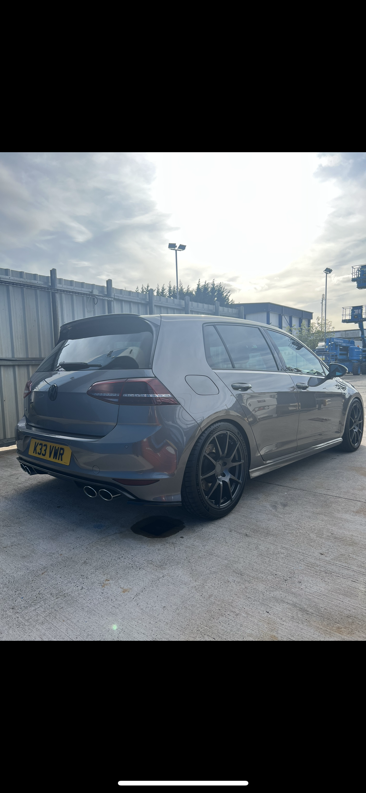

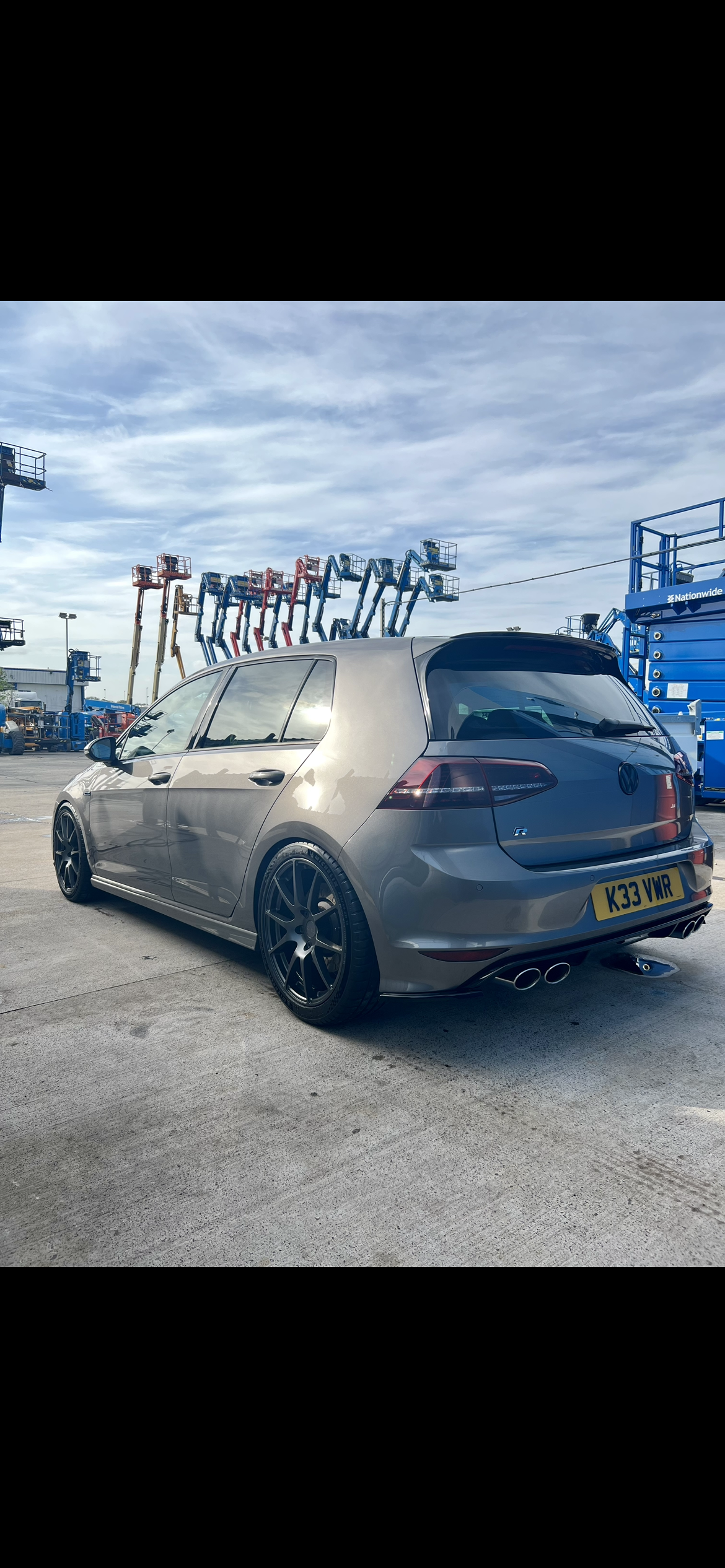

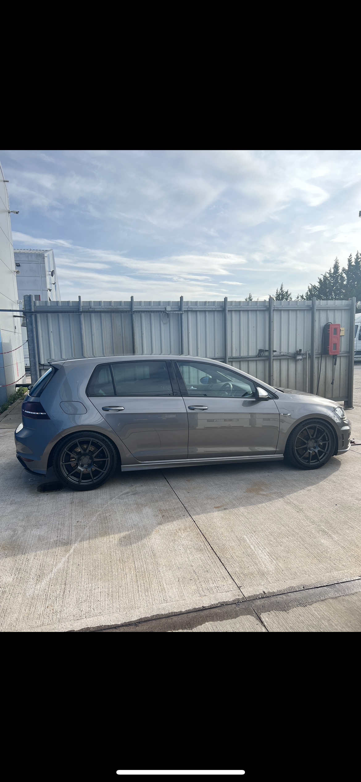

K3VWR Posted February 26, 2023 Report Share Posted February 26, 2023 22 hours ago, scoobyc said: Thanks both, I think if I was going for lowered springs I'd try the Emmanuele Design ones from what I've read up on recently but oe seems like the best way forward and I'll do top mounts and bump stops. Appreciate the higher quality stuff would be a big improvement but can't justify it on my work car currently 👍 22 hours ago, scoobyc said: Thanks both, I think if I was going for lowered springs I'd try the Emmanuele Design ones from what I've read up on recently but oe seems like the best way forward and I'll do top mounts and bump stops. Appreciate the higher quality stuff would be a big improvement but can't justify it on my work car currently 👍 Hi scoobyc I’ve been running EMD springs for the past three years. The ride is pretty much the same as standard on passive shocks maybe a tiny bit more harsh. Here’s some pics for reference. 👍 scoobyc 1 Quote Link to comment Share on other sites More sharing options...
