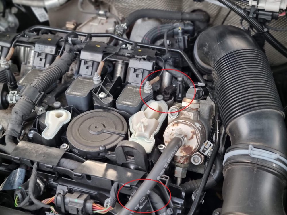

As suspected I believe there will be two. One is besides no. 4 coil pack - exhaust cam sensor. The second, intake cam sensor, is more or less in line, but around front of engine, underneath the lifting hook on the right, access a lot more difficult.
You can't see it in the photo I attach but I have circled location of where both are. You can see the exhaust one in the photo. I could not validate part number on the intake one, due to access, but it certainly looks like it is a hall sensor.
