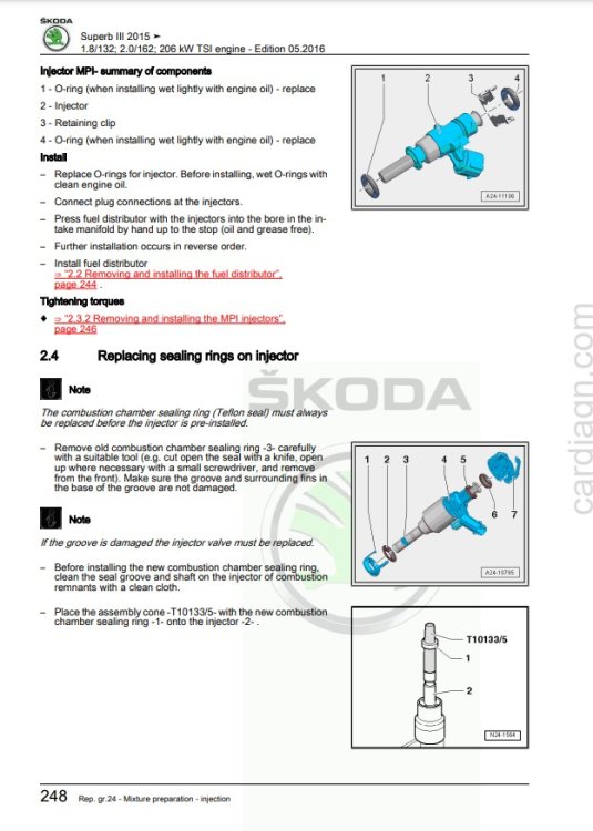

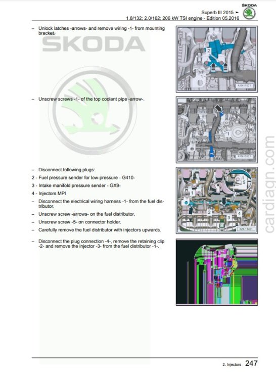

Find service manual, it is described there.
Its pretty easy and safe, unscrew piping from the rail, low pressire, uncrew few wire holders so you can reac rail and unscrew rail and detach it.
I can send you instructiins for Skoda, its the same.

Appreciate it thanks that would be great
