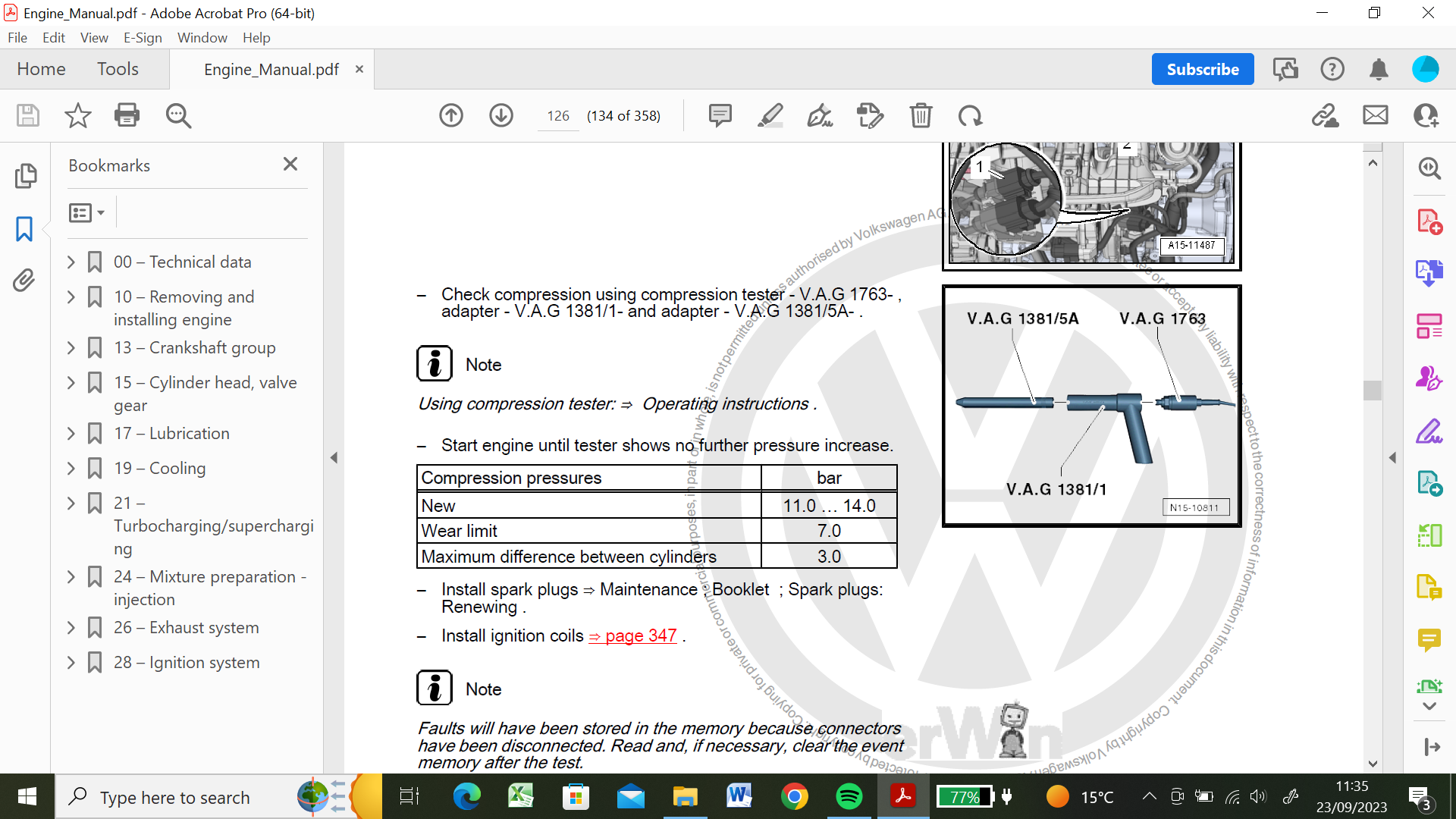

Oh. Sorry to hear that. From what I can recall reading wear limit is 101psi and max differential is 43psi per cylinder. I will try and confirm in the vw manual I have.  Technically, you'd be within that. But 27 is quite high and you have to wonder if that is the cause or contributing given its the problem cylinder. What did the plug look like. Is it fouling?
CJXC compression tolerance in vw manual.

Most guages do read differently. You're still looking at 25psi differential to cylinder 1. Is it the cause of the misfire though?... it's not out of spec but it is the problem cylinder...co-incidence only or root cause?
