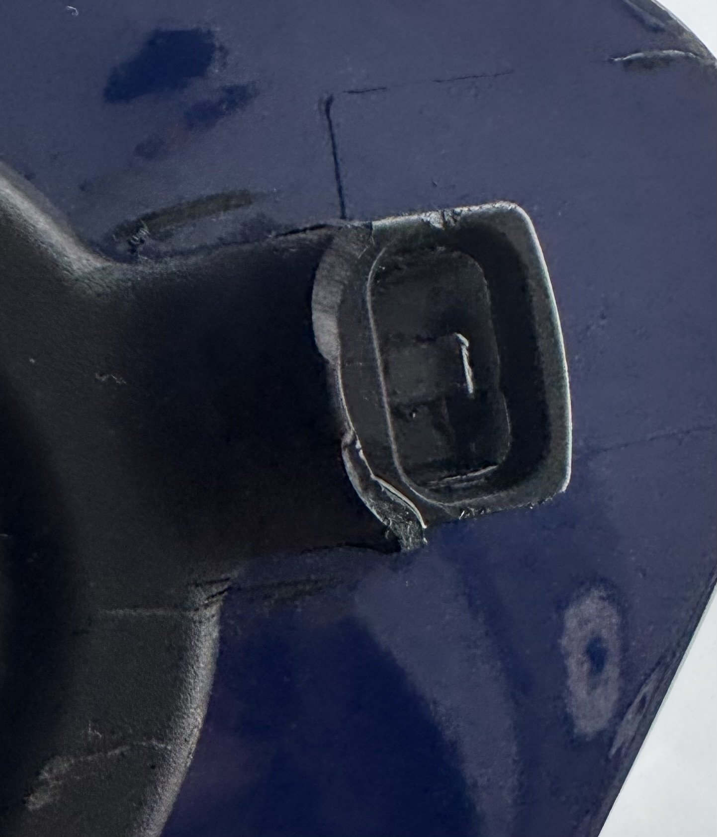

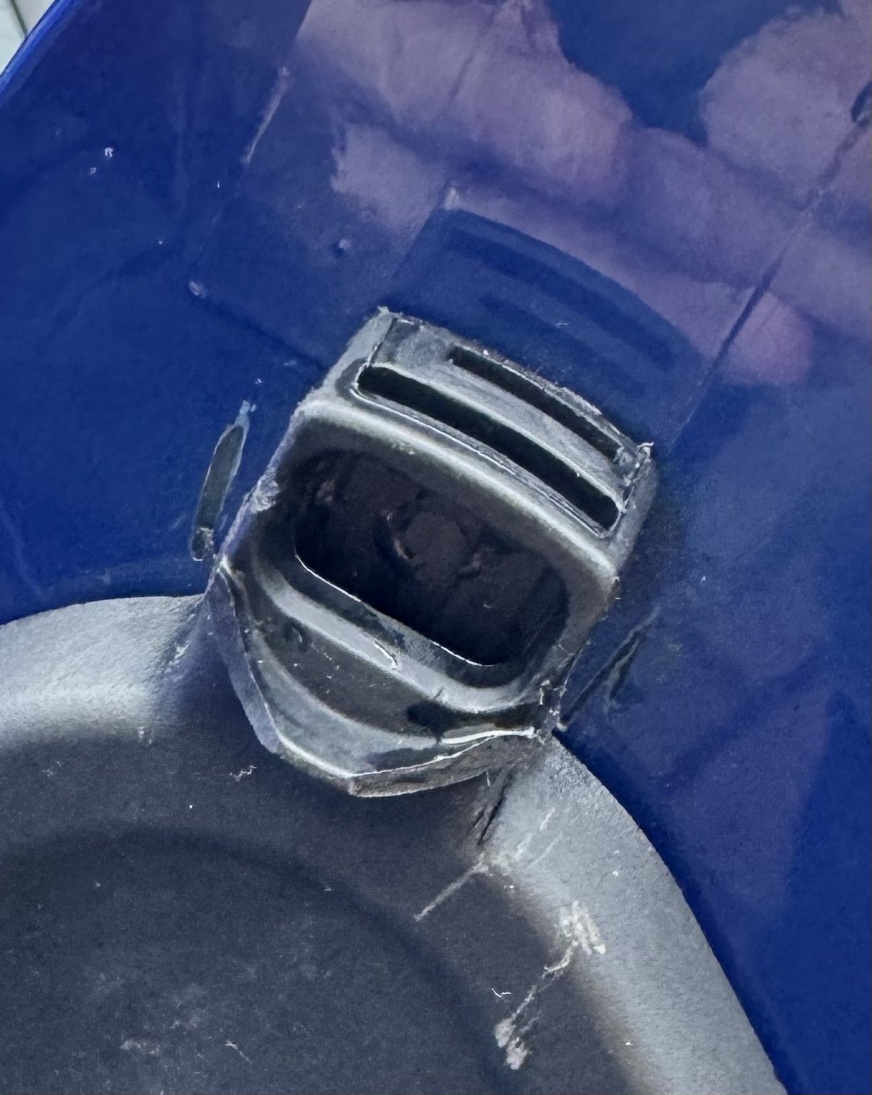

If anyone is struggling with a sticky fuel flap… there was supposedly a VW tech bulletin on it, that involved shaving the catch… here is the end result from the garage…. not pretty but it no longer sticks!

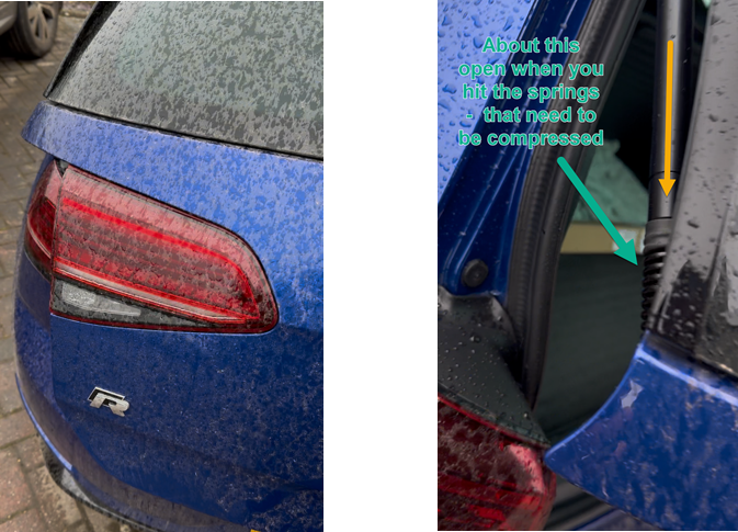

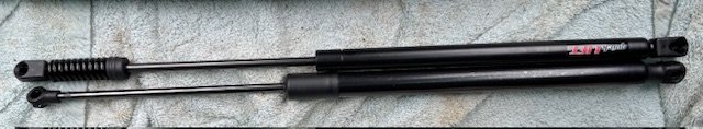

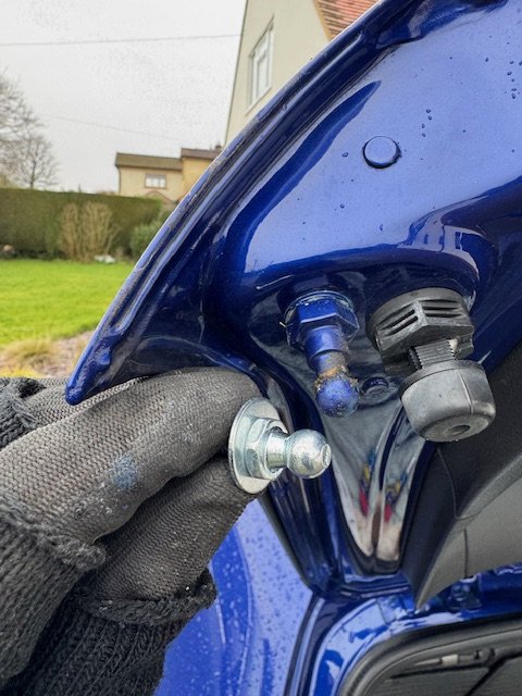

Quick Lift - Automatic / Pop Boot (Trunk) Opener Lots of people seem to go for the Emerald Struts ones - but I found mixed reviews. So having read this thread, I switched to the Quick Lift ones from Poland off eBay (link and their store is here). Note there are 2 types from Poland on eBay, the other company doesn't list the Golf R (due to the extra weight of the spoiler I found out)... saying that, I did buy theirs first for my MK6 TSI, and they are good too! The struts fit easily enough - 15 mins should be long enough once you have found all the relevant tools - a 13mm & 16mm spanner, a small flat head screwdriver, some kitchen towel (to clean the old ball joints), something to hold the boot lid open with (I had one of those long piston things for holding up plasterboard - but an appropriate length of wood will do the job just as well), and I also used a little bit of extra lithium grease on the joints. N.B. You do have to replace the Ball sockets on the boot lid with stronger stainless steel ones that are included in the kit, and a key bit of information you need to know is you MUST remove both of the old struts before fitting the ones, as they are a tiny bit longer than the originals and won't fit otherwise. Looking at my uploaded video of the boot opening, the new struts look quite fierce - but they aren't in reality. I'm also told the springs (that fire the boot open) will lessen a little after the first ten days, as you do need to push quite firmly to close the boot. Let me explain a little more, to close the boot, for the initial 60% of the arc, you are pulling down against the pistons - not too much of an effort there, but then you hit the springs that are used to push the boot open when you unlock it... at that point you need to switch your hand to pushing down, either on the bottom half of the VW badge, or the top of the rear wiper arm clamp - all doable, it just needs a bit of practise! Ok I really think that's it for my mod list....
