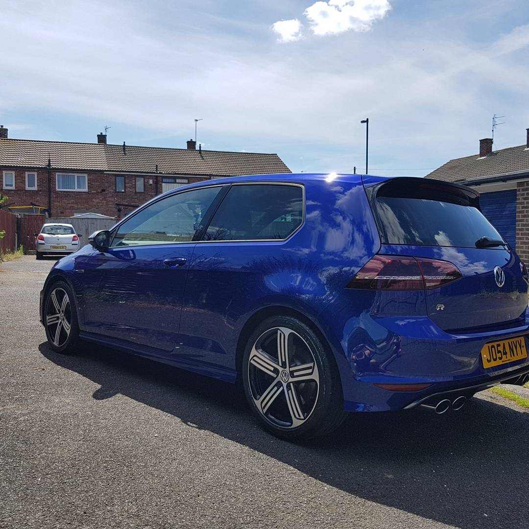

It's my car on the other link. I had a similar issue, put my foot down and when I got up to decent speed a huge cloud of smoke but no loss of boost, pulled over for 5 minutes started the car again and smoke was gone. Went out again and tried on the same type of road and this time smoke again and went into limp mode. Turned car off and waited 10 minutes and then was fine again. Garage I go to did every test they could and everything was fine. Fault turned out to be the pcv valve had a slight leak so replaced that and done 300 miles since with no issues. Is the car smoking even after you have turned it off and on?

So cars been to the garage and it looks like the pcv valve needed replacing as there was oil in the inlet manifold. All replaced and car seems fine.
