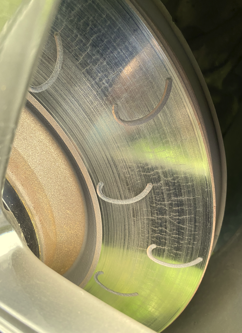

These discs are about two years old now, and have done around 8-10 proper trackdays with some general street driving in between. Around 6k miles at a guess. They still perform really well. I don't get pad material deposits on them as the pads are quite hard and aggressive, but they do generate a ton of heat when on track. I've had them go blue on a number of occasions and that's with me generally sticking to sessions no longer than 20 mins. BUT.... i will still go BBK next time around. -

I found the stock brakes to be just about adequate for the street. On track, no chance. You may have a warped disc, or it might be deposits of pad material sticking to the disc when they get super hot causing the wobble you felt. The fact you've not experienced it over the coming weeks probably means its been worn off. No point in taking the car on track with stock brakes as they will ruin your day. Get yourself some new discs all round, with uprated pads plus braided lines and race fluid as a bare minimum. -
