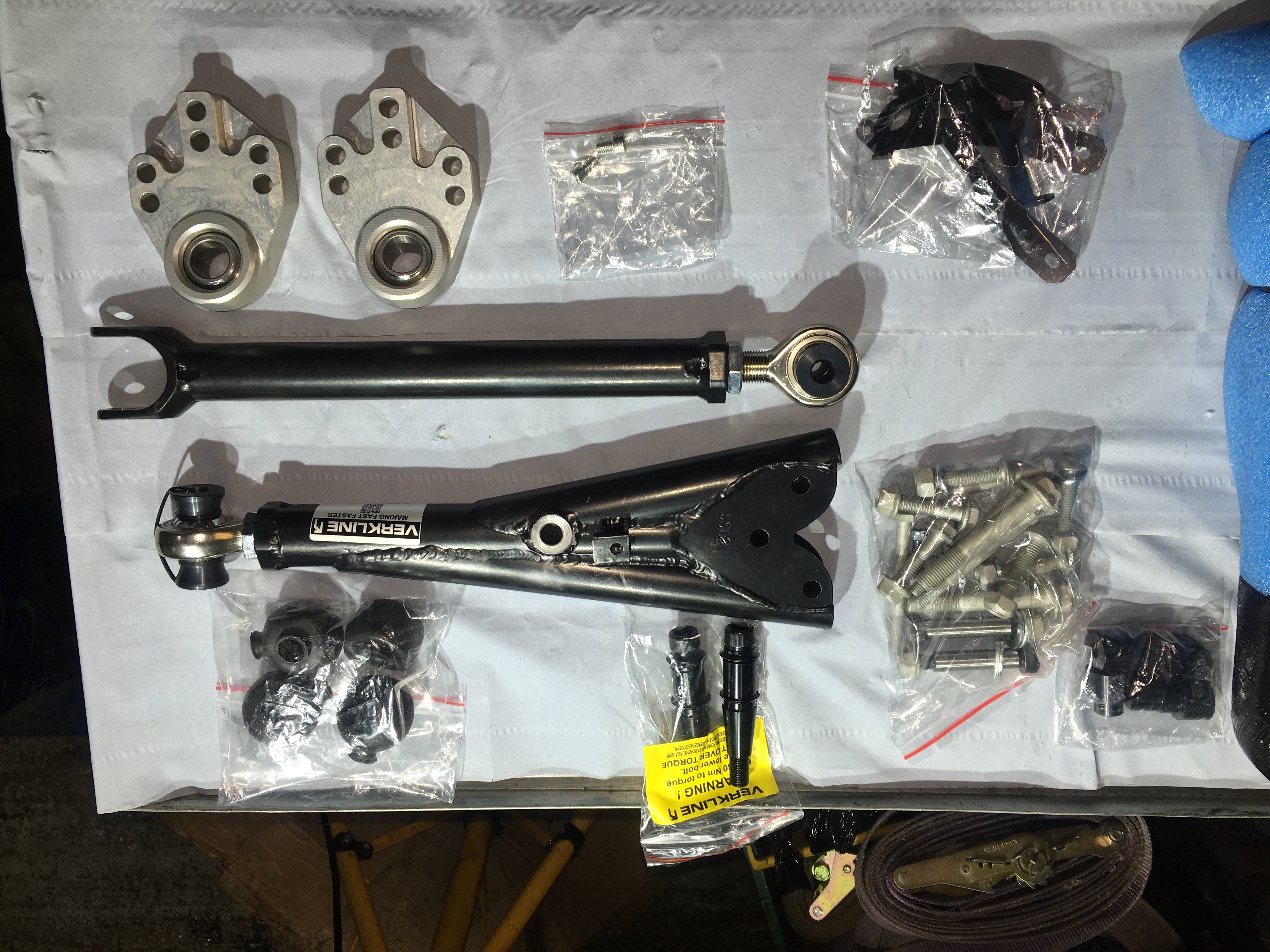

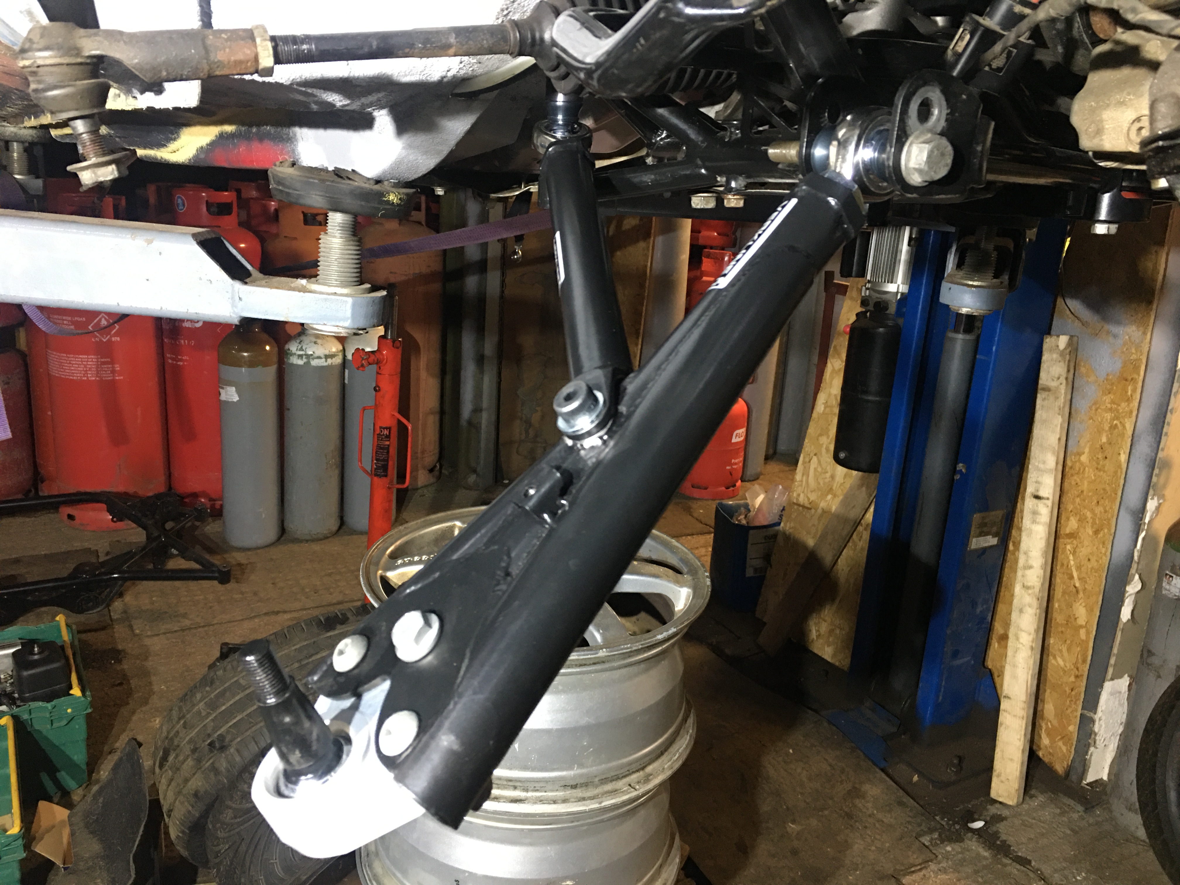

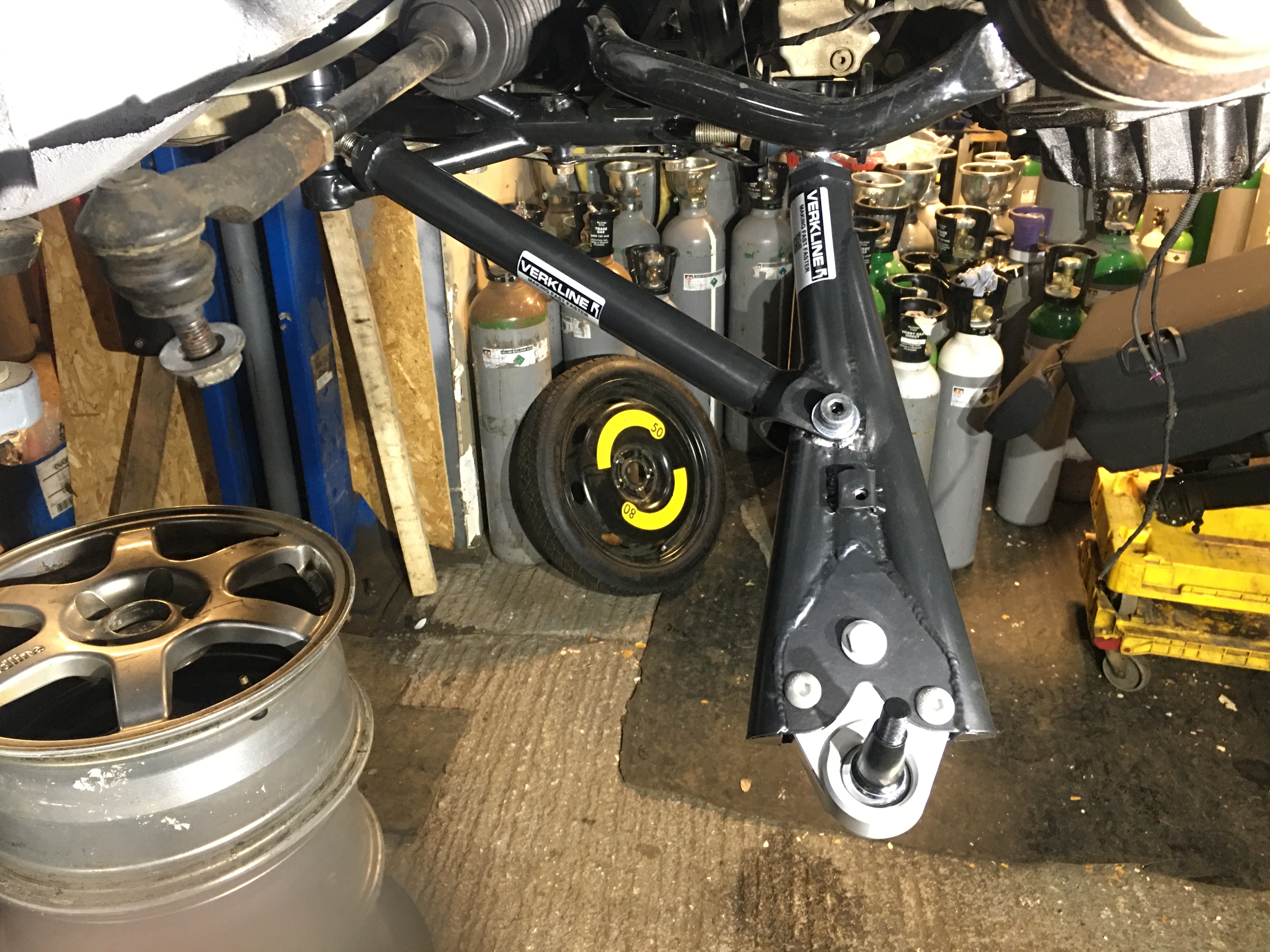

These wishbones are really well made and are fully adjustable for camber and caster. The tubular subframe also allows the wishbone to be relocated within the subframe to improve suspension kinematics
Hi Everyone, just a small update this week as I was waiting on parts to arrive. To complement the Tubular subframe I ordered the tubular wishbones.

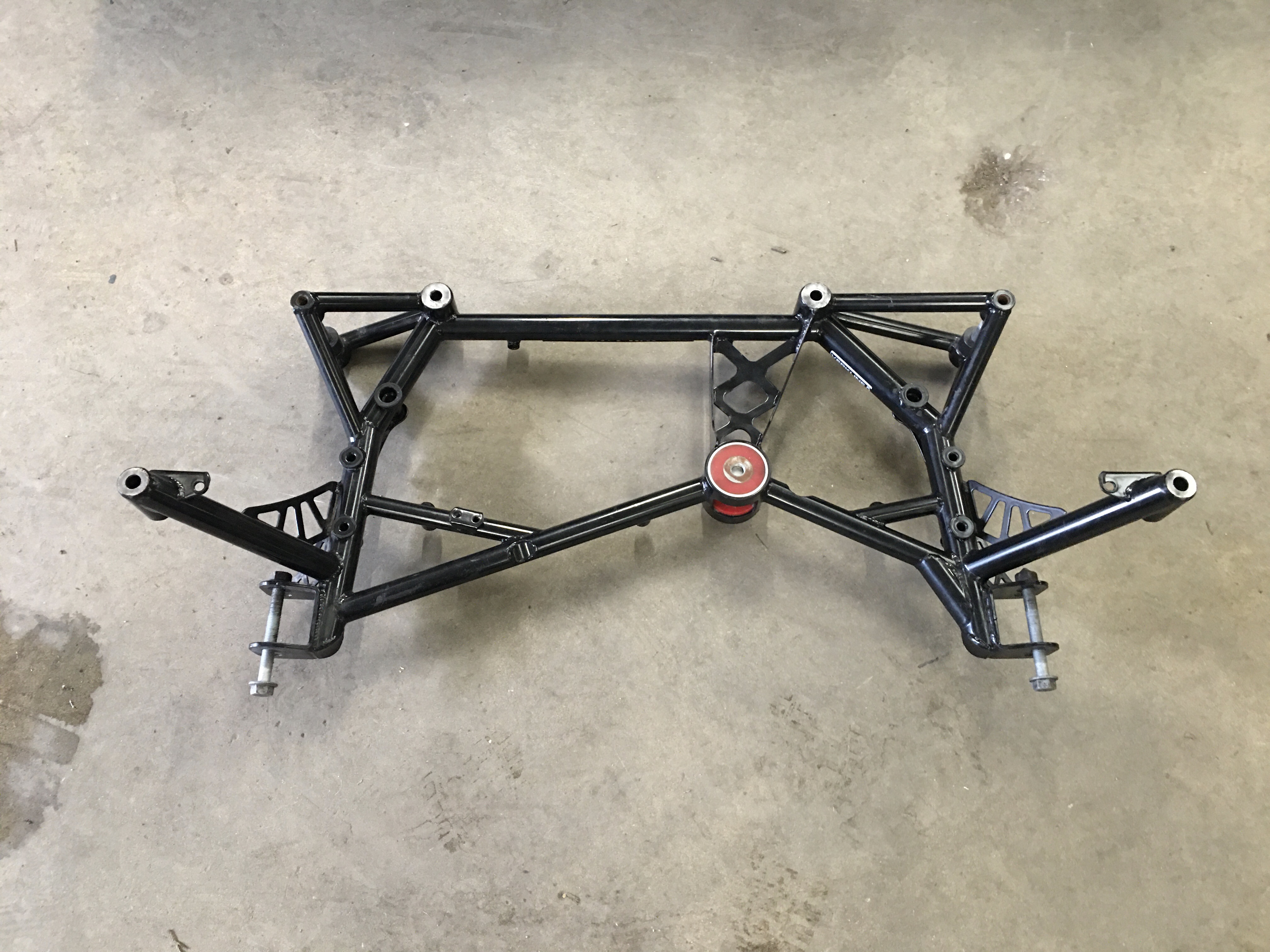

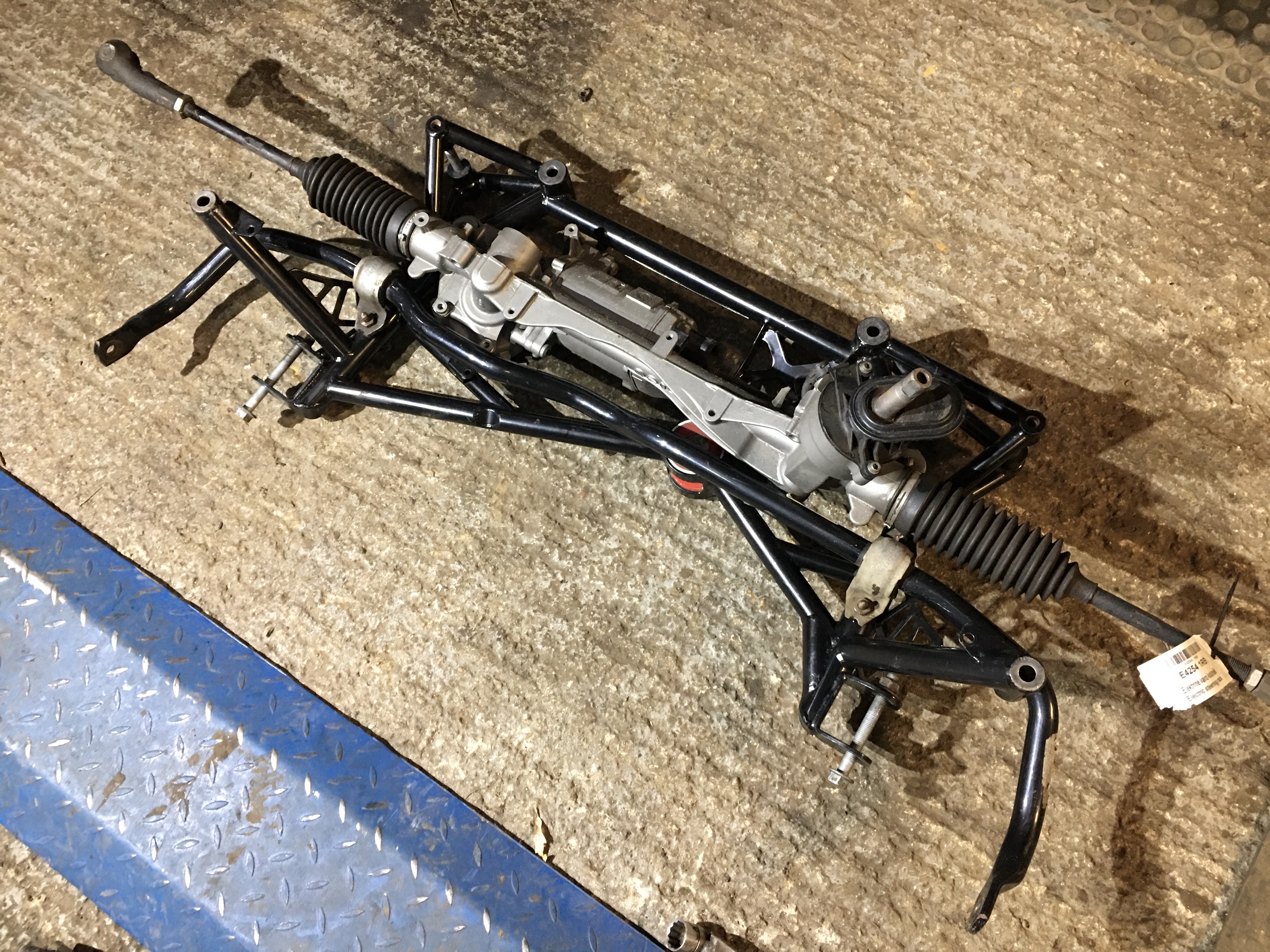

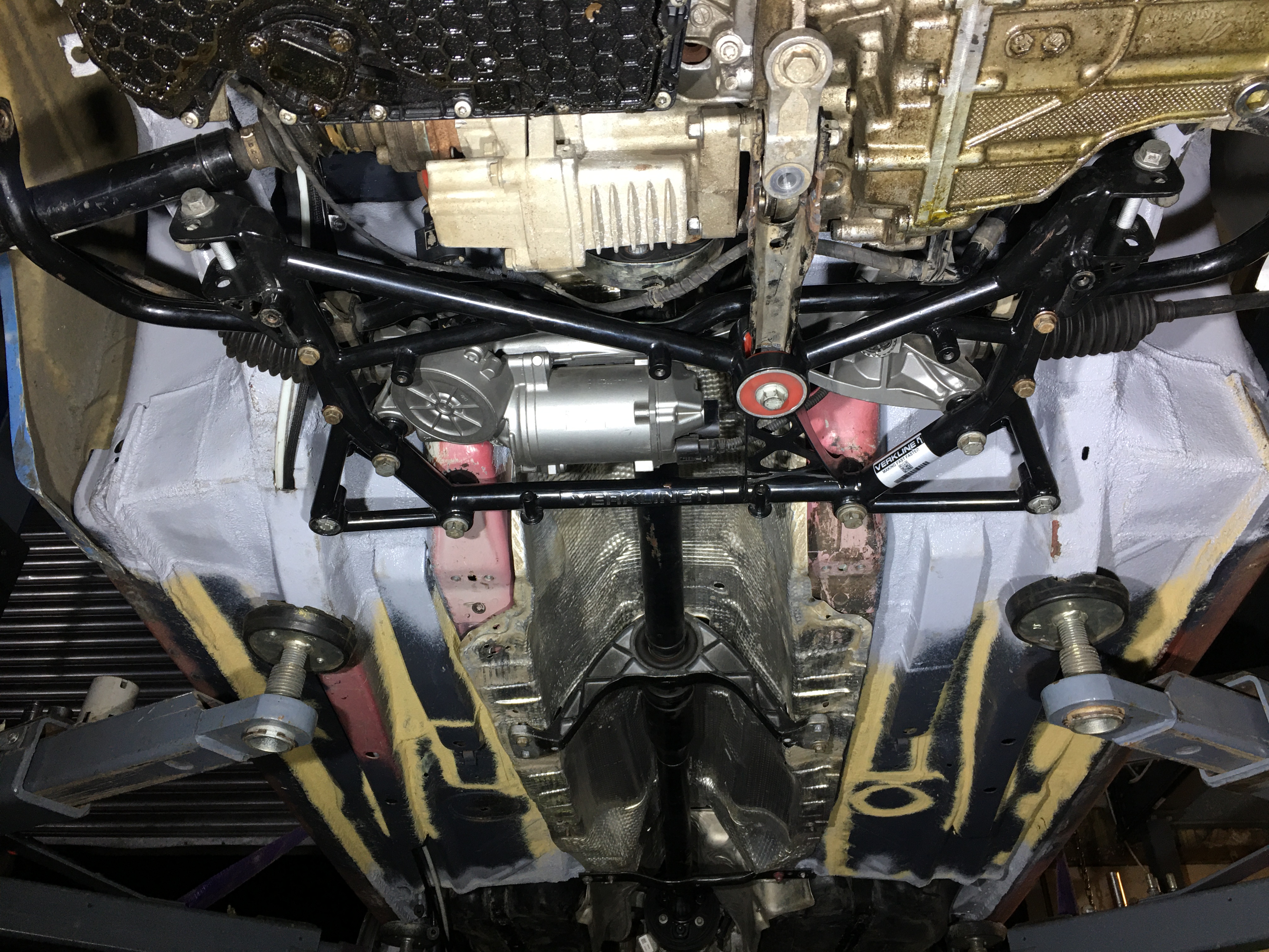

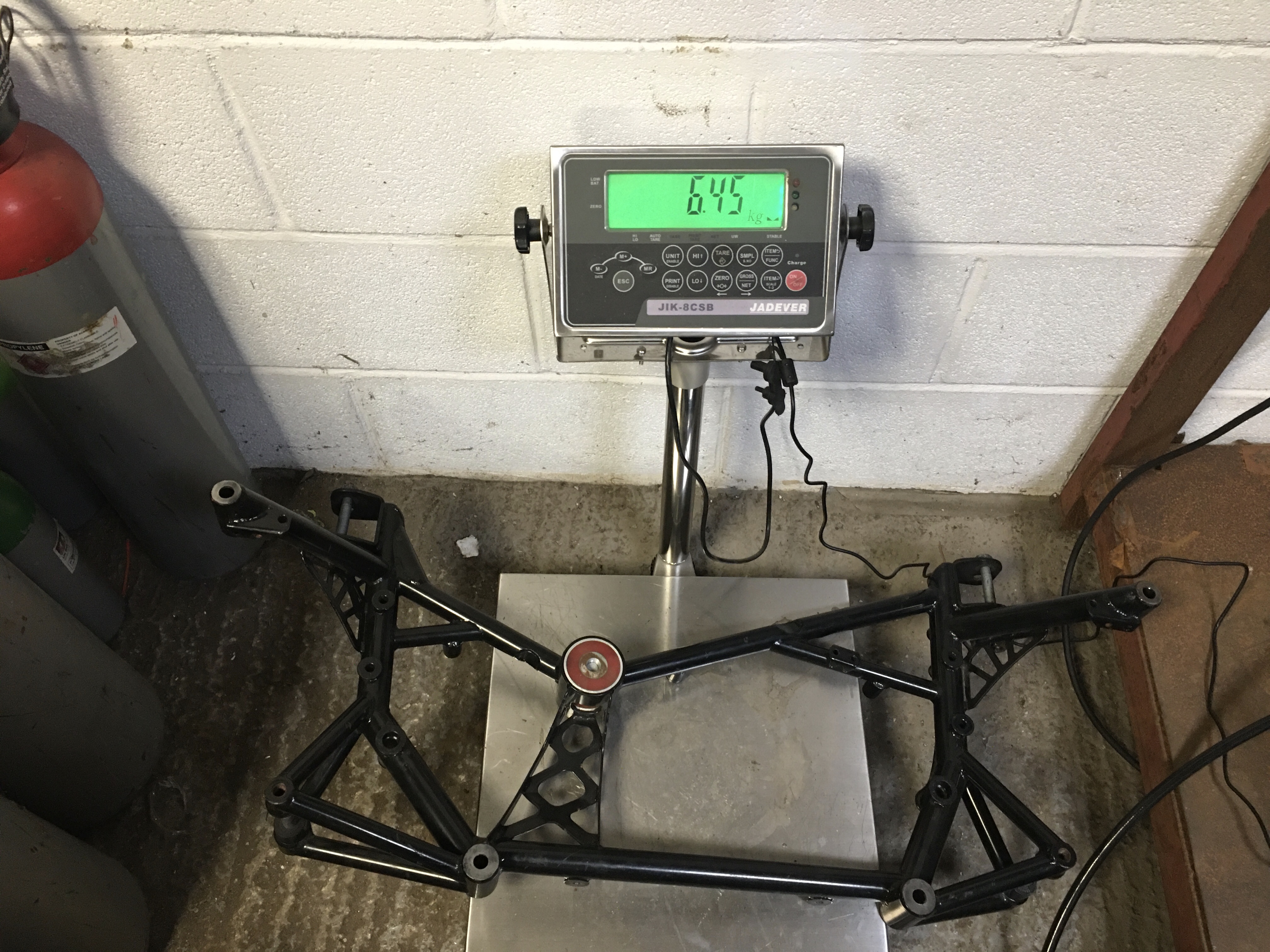

Eager to get the front subframe on I got straight to it. R Steering rack and anti roll bar installed and a quick weight check compared to steel subframe the Verkline front frame is 5.8kg lighter This takes the total weight saving to 13kg inc the front brakes
The next change was unplanned, I had been looking Verkline products for a while but couldn’t justify the cost. Two subframes came up around half the cost of the original so I snapped them up.

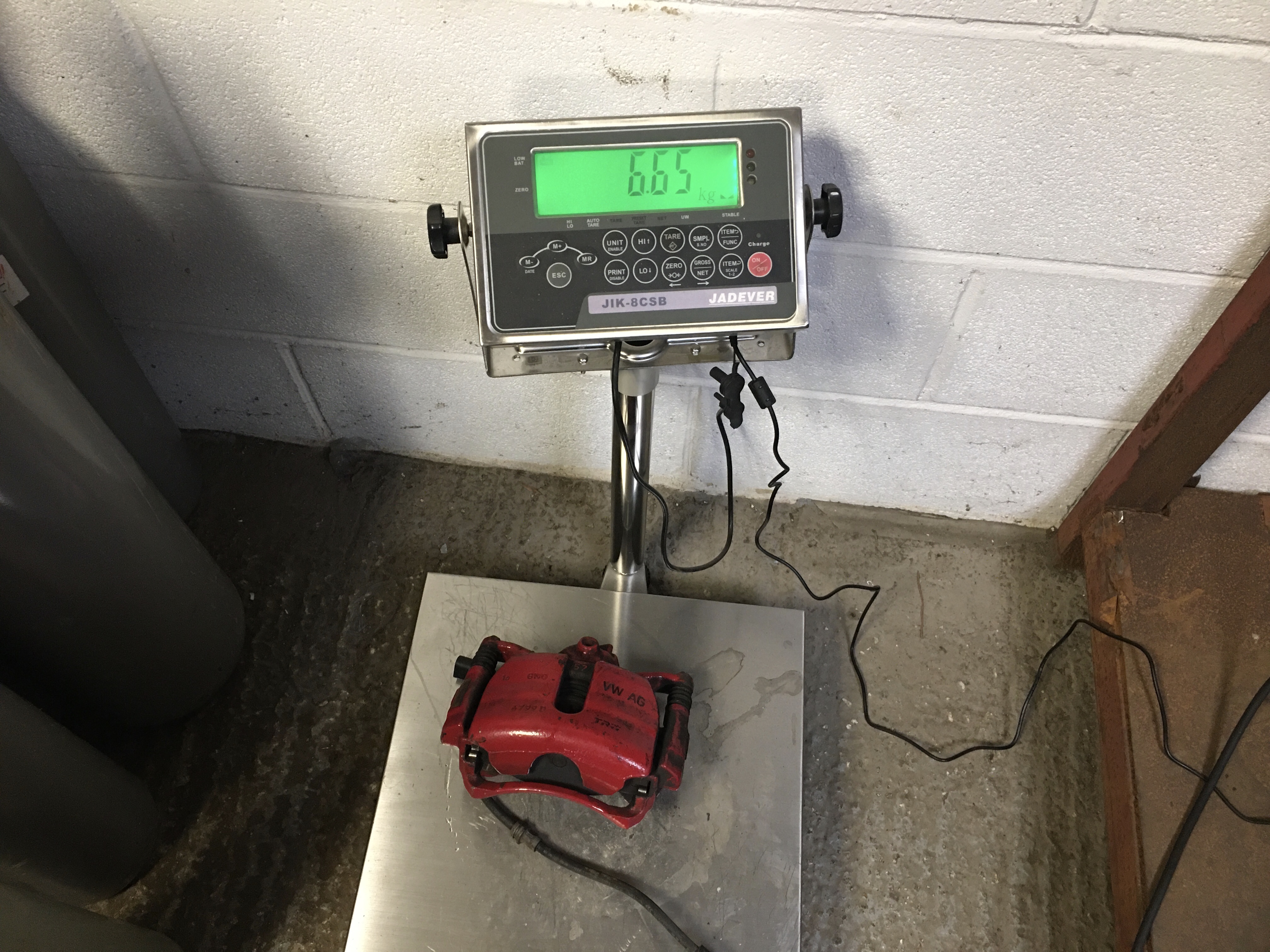

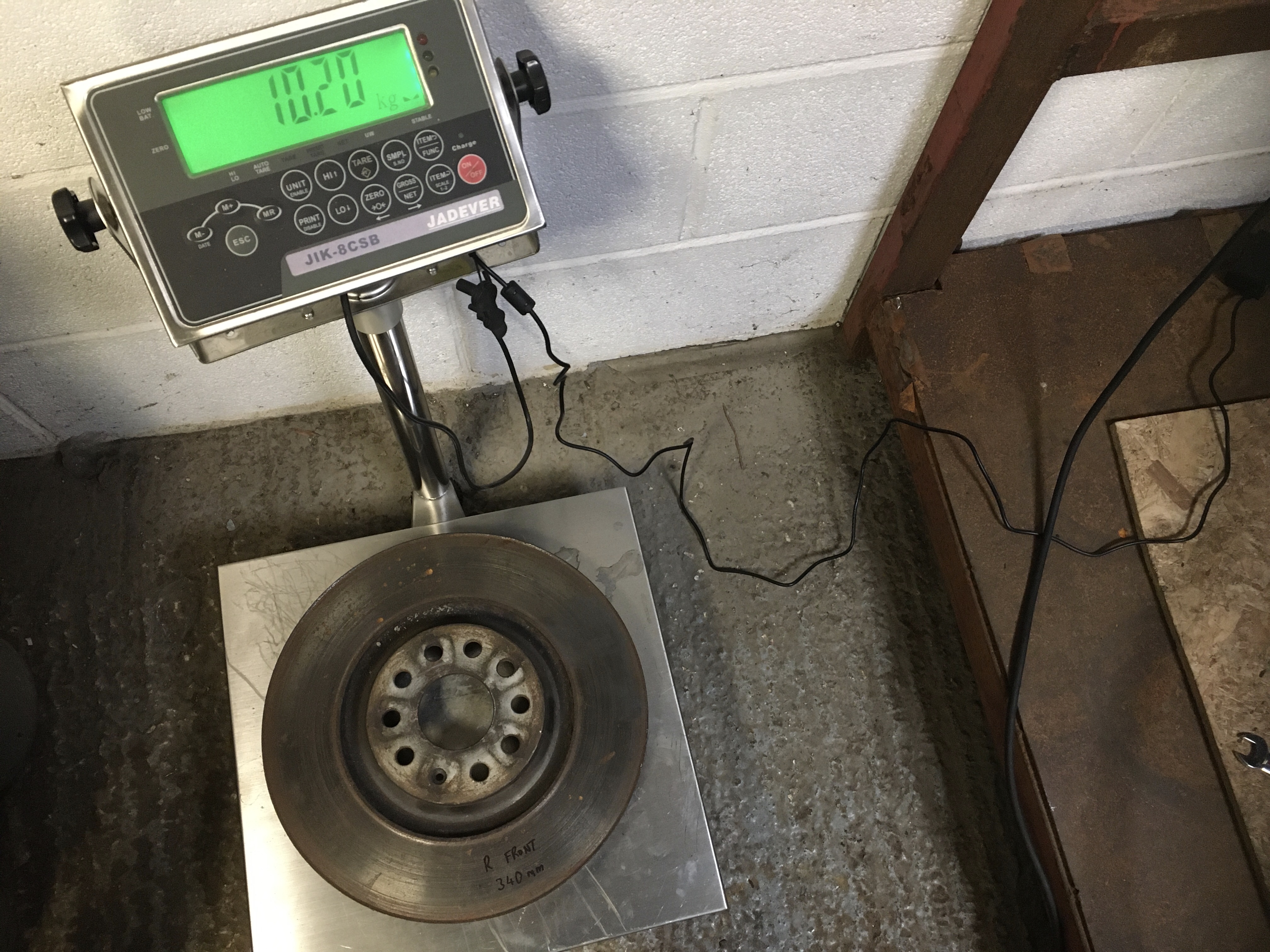

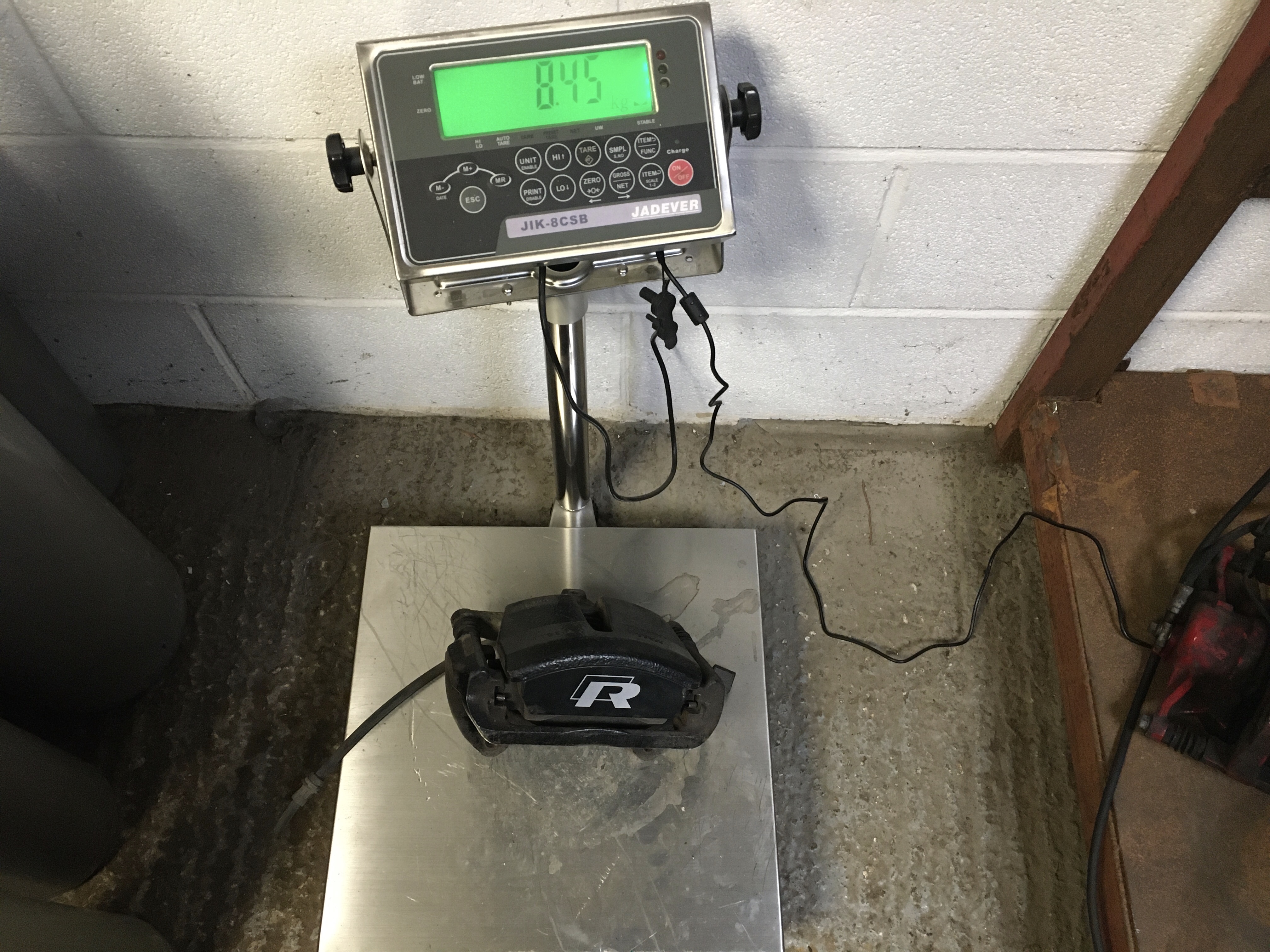

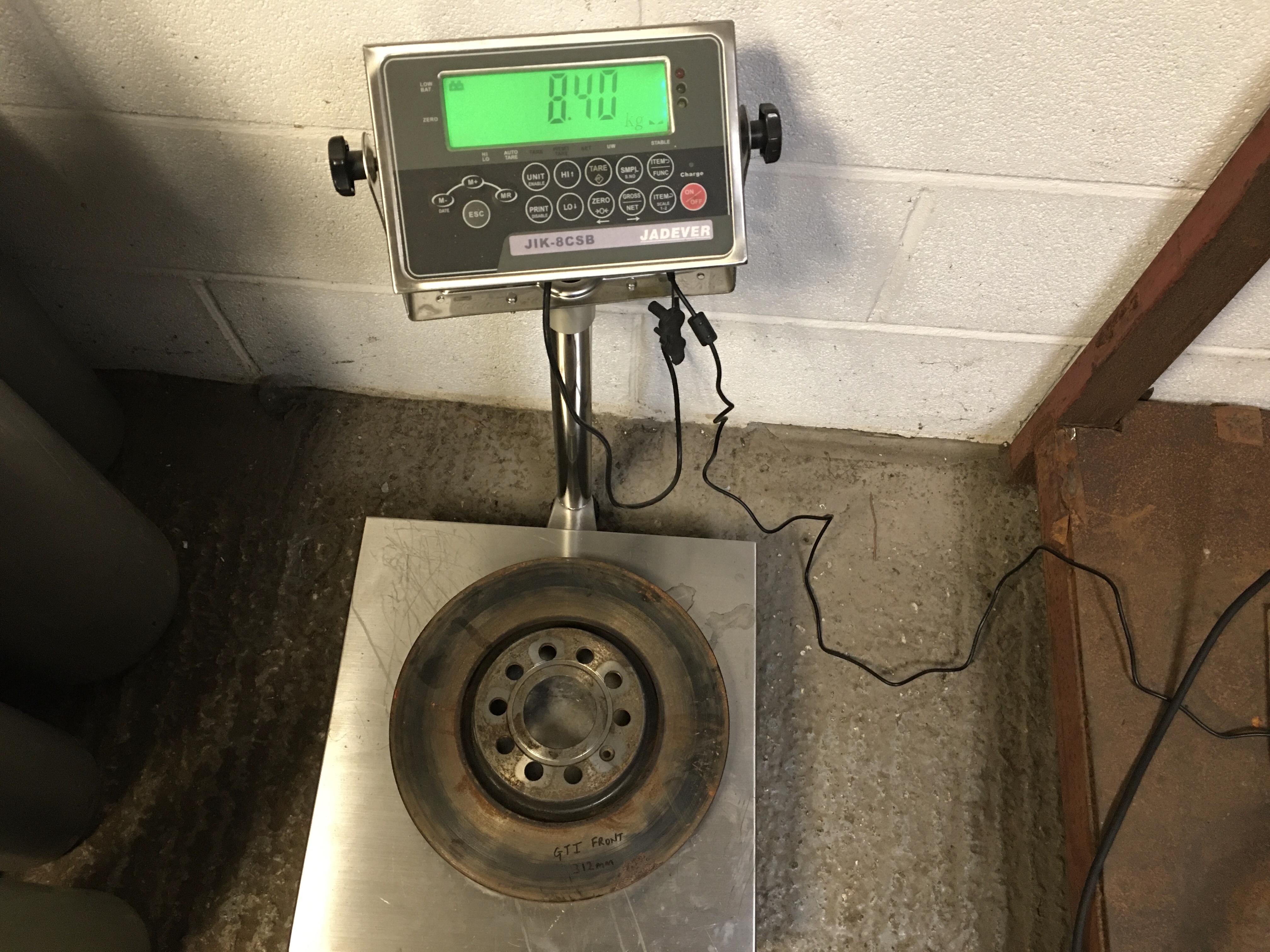

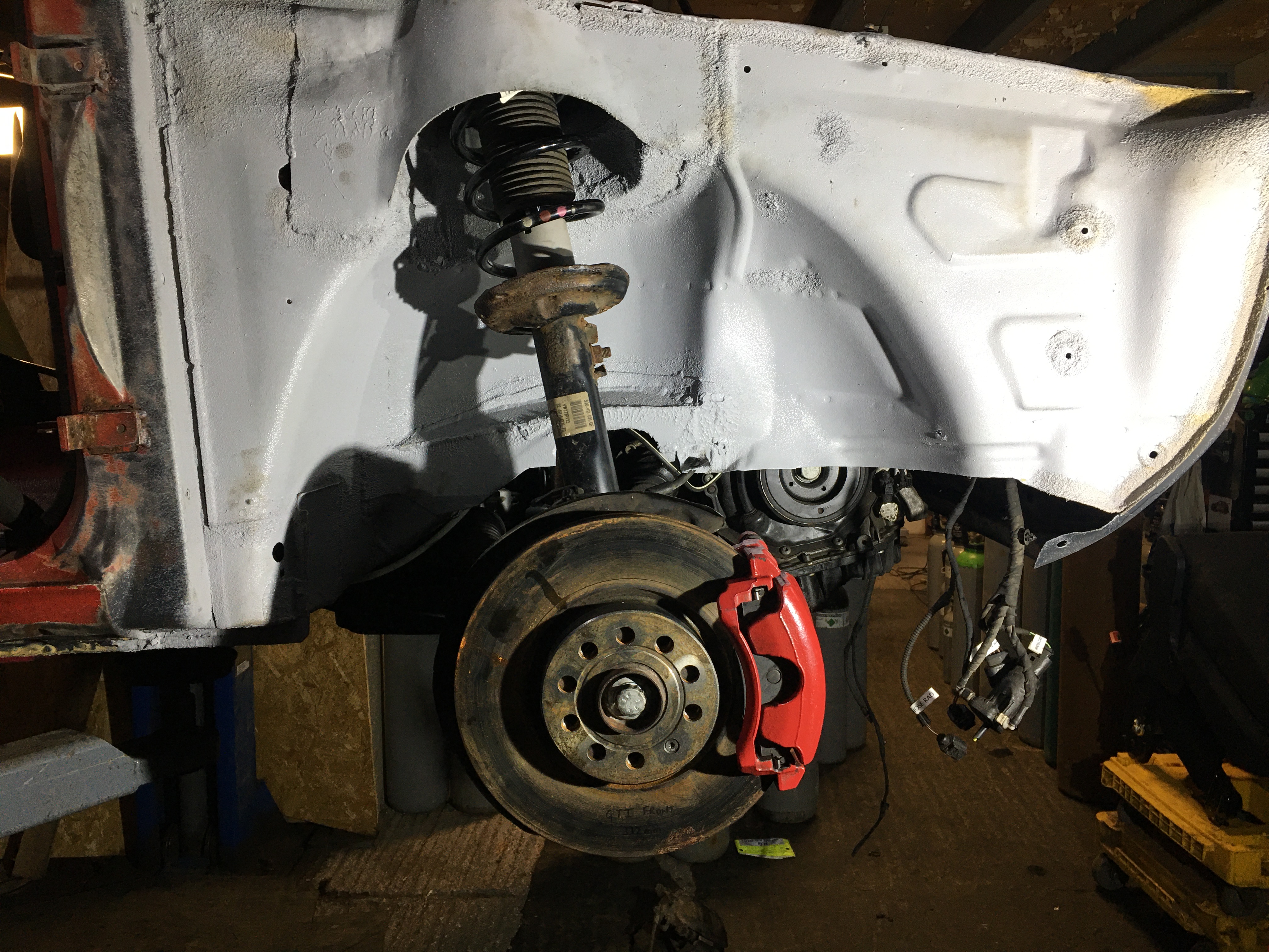

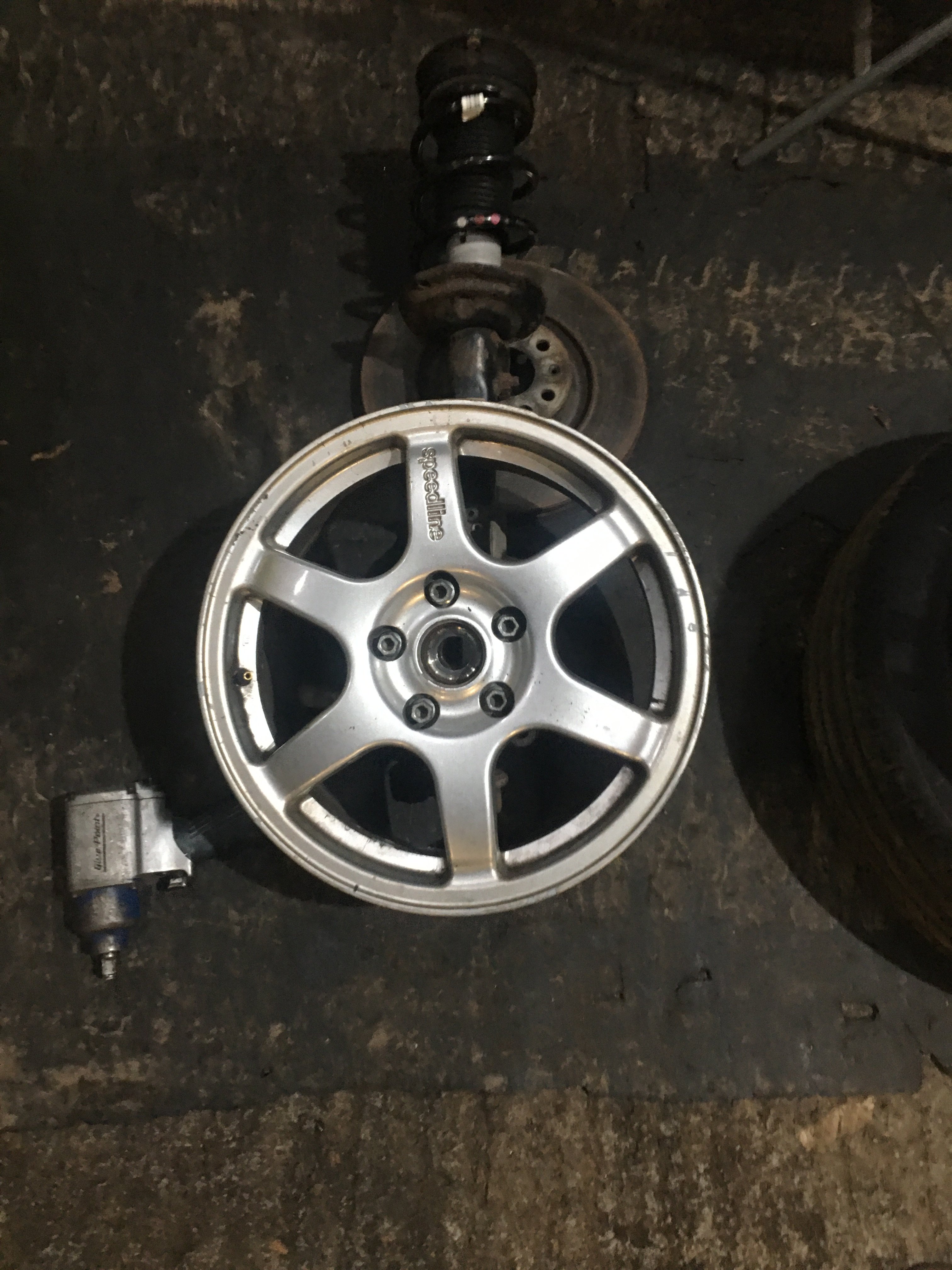

The GTI set up proved to be a decent weight saving over the R setup, that’s a good amount of unsprung weight removed. GTI Front caliper - 6.65kg ea R Front caliper - 8.45kg ea GTI Front disc - 8.40kg ea R Front Disc - 10.2kg ea Total saving - 7.2kg

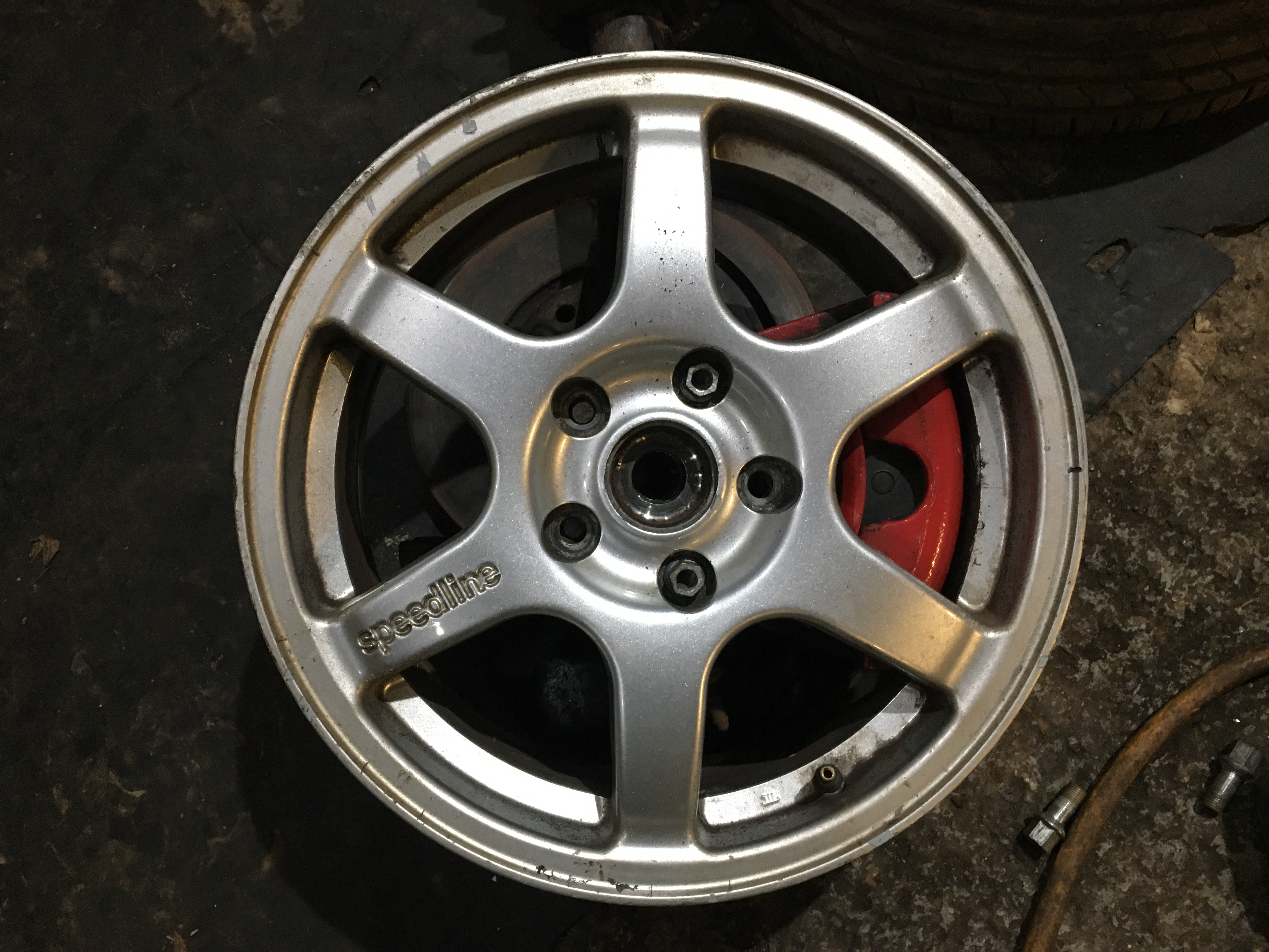

Hi Everyone, I hope your all well. Sorry I haven’t posted any updates in a while. Things have been a little quiet on the build as my kids have started go karting, which has been a steep learning curve and a rather expensive one. Anyway, on to the build update. I had reached a bit of a crossroad, where certain decisions needed to be made regarding wheel and brake size as well as suspension setup. I’m determined to keep the mk1 looking original-ish as possible, by that I mean trying my best not to use berg cup style wide arches. This has left me quite a large headache regarding wheel choice. I needed a 16” wheel which was 7” or less wide, 5x112 with a high ET. The following posts will run through some of the choices I made.
