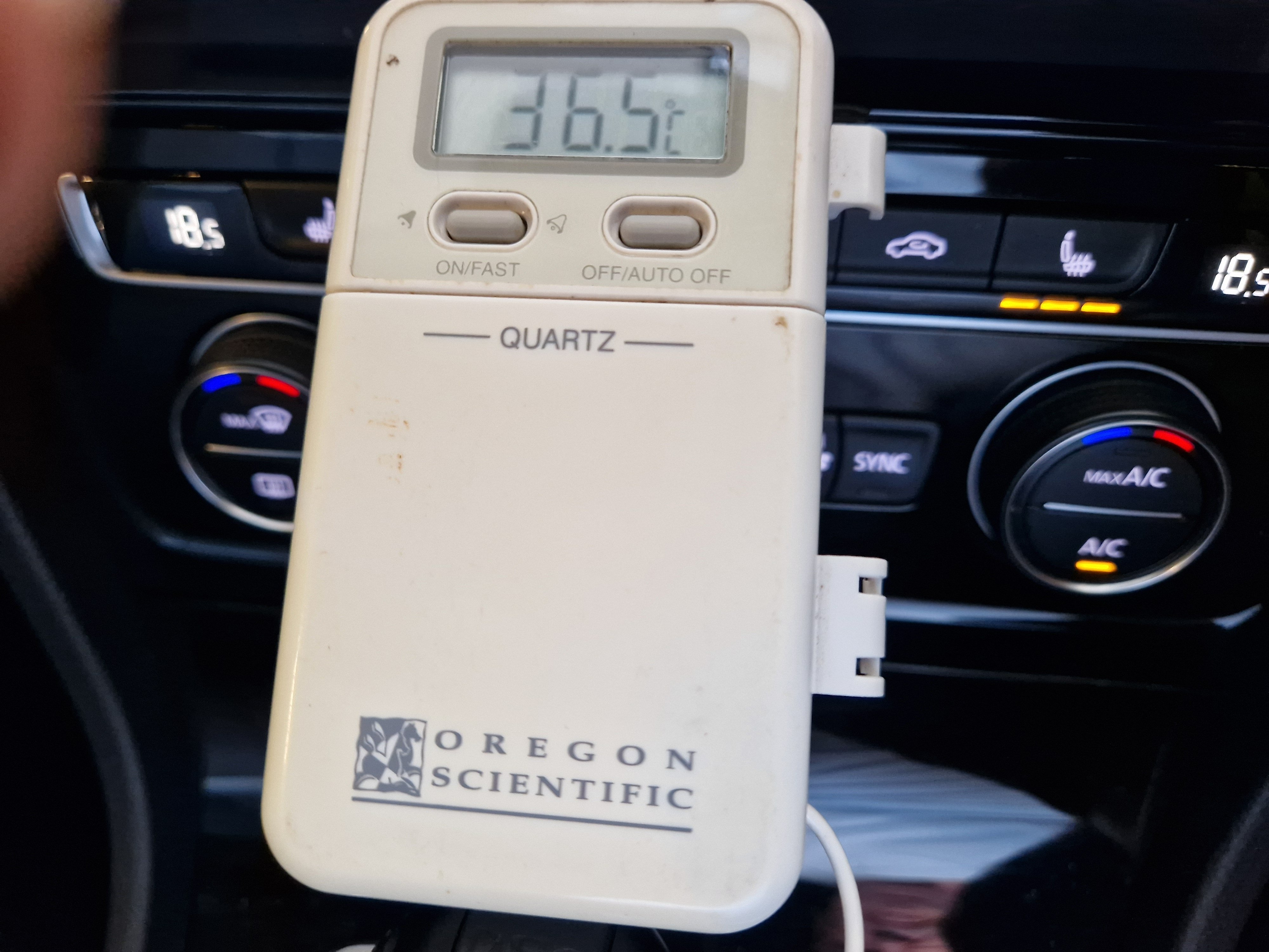

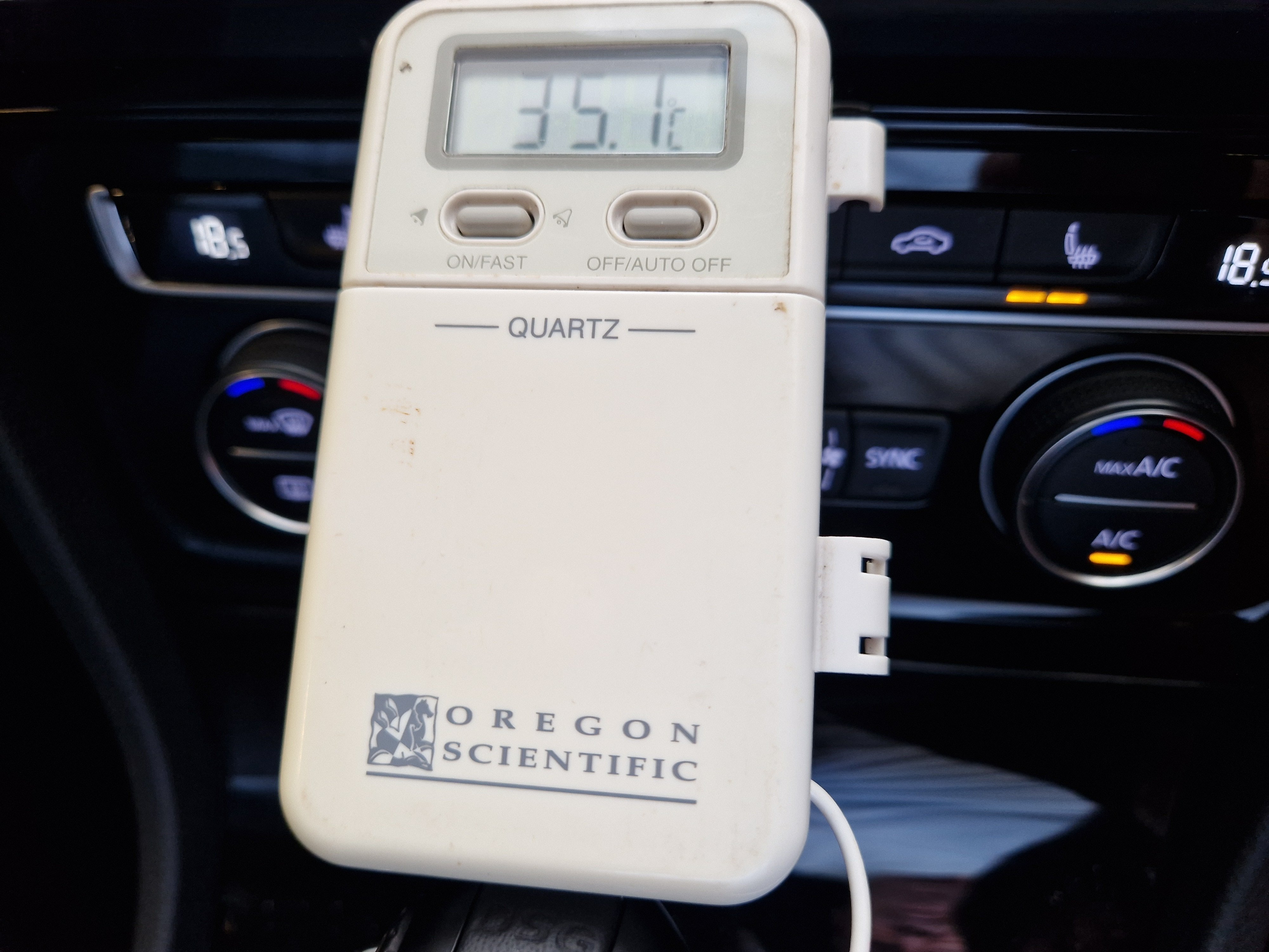

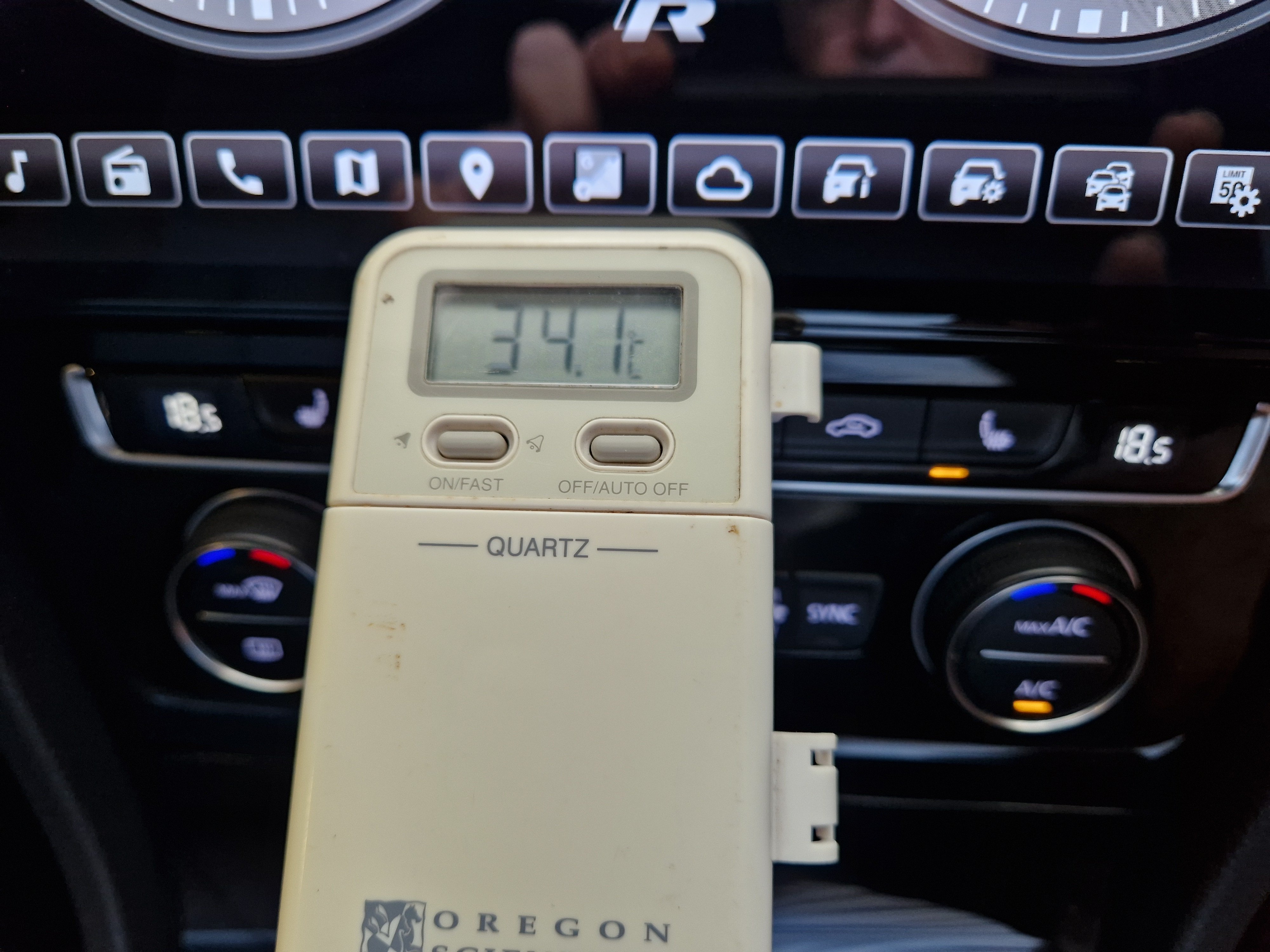

Sorry, but that shows AI has no idea how the system actually works.As I explained above, the 3 way heating control is entirely controlled from the car end, not the seats themselves. There is no logical way that it could only work as on/off. If it works at all it will work as OEM with 3 settings. Although my Audi seats have 2 seperate circuits for base and back (unlike the Mk8 seats which have just one) with the back circuit connected to my 7.5, the full 3 stage OEM heating works perfectly (EDIT see pics attached). I am convinced from all of the official diagrams I have seen that the Mk8 seats when wired correctly would give full OEM 3 stage heating.
