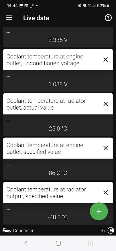

@dv52 Hi Don - Just for interest. Ponder this selective live data capture which was taken when my car was fully operational no faults and no cooling system issues (1 year after I replaced the electromechanical thermostat and water pump). What I was saying is -48C also seems to be produced in a working vehicle in the SPECIFIED value (not actual read value) for the rad outlet (temp 2 ntc). Yet, despite the crazy specified value, it does not cause any noticeable mis-operation and although I do not know for sure - I think it is like that from new. I suppose looking at it the other way - there may be no ECU reliance on Specified to Actual temp at Rad Outlet. There is of course management of the delta temp between engine and rad outlet sensors though as that is what the ECU uses to monitor cooling system effectiveness and will report a DTC fault is that drops out of expected ranges.
I love the intracacies of the mk7 Ea888 gen 3 cooling system.. Some good info above - as usual - I would expect no less of Don. The minus 48C is a specified radiator outlet value. I can't remember why it appears to be an error but it doesn't affect the proper operation. You need to look at rad outlet temp - actual value. One way to check the cct is operating is to unplug the g83 and see if a full scan shows open cct on the temp 2 cct. Of course, you can also prove connectivity back to the pins. If your faults are all resolved this is just sign posting for other searchers... The faulty cap would cause potential boiling at operating temps but I'd be most surprised if it is the cause of a circulation issue. Fwiw the coolant expansion tank should be replaced as well if it is original. They fracture around the level pins and can cause coolant migration all the way back to the cluster or ecu. Which is not fun.

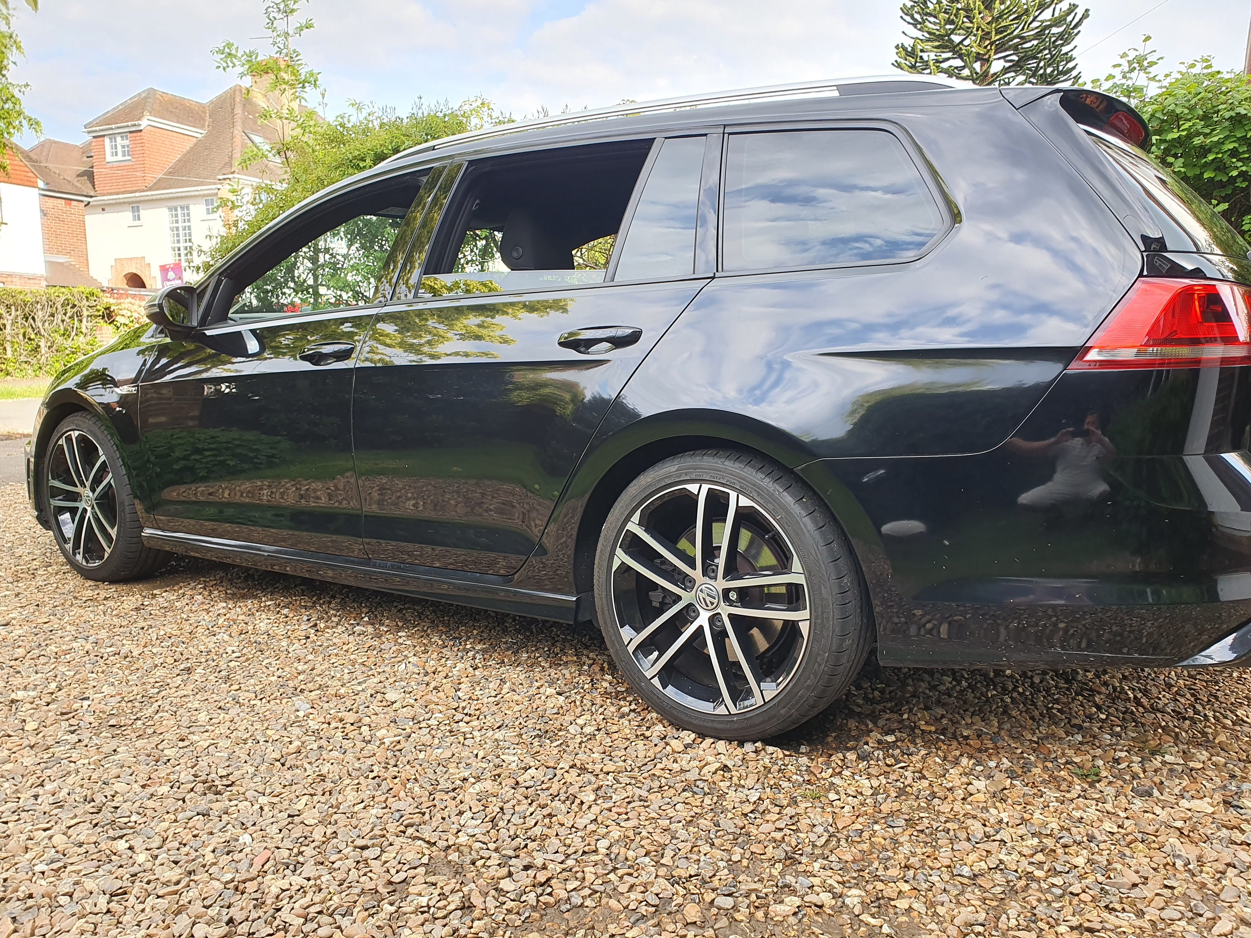

I never really liked the cadiz either. I bought some 18" nogaro's off a gtd. Much better looking wheel imo. Added images x2.

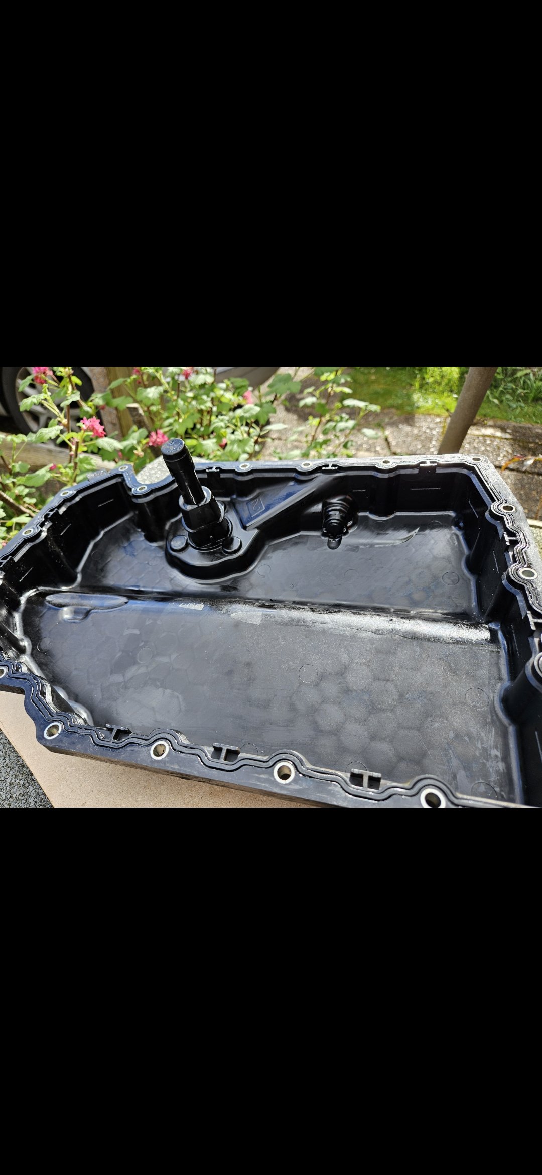

The leak cause, with mine, and undoubtedly others, is just the hardening of the gasket. New gasket and resealed oil level sensor = no more leaks for me. Pretty easy job at oil change time. A long torx bit for a drill with the pan bolts saves your wrists and time. I dont have a motor ratchet... You can also fit gen 2 metal pans i believe but more money and faff because you have to rtv it all. No doubt there are performance sumps available too... The diverter looks superbly made. Not cheap tho. I'm still running stock original diverter at 102k miles. Even at stage 1 levels, my feeling is they either hold boost or not. It's kind of binary for me in my mind. But i've no experience of running upgraded ones!!

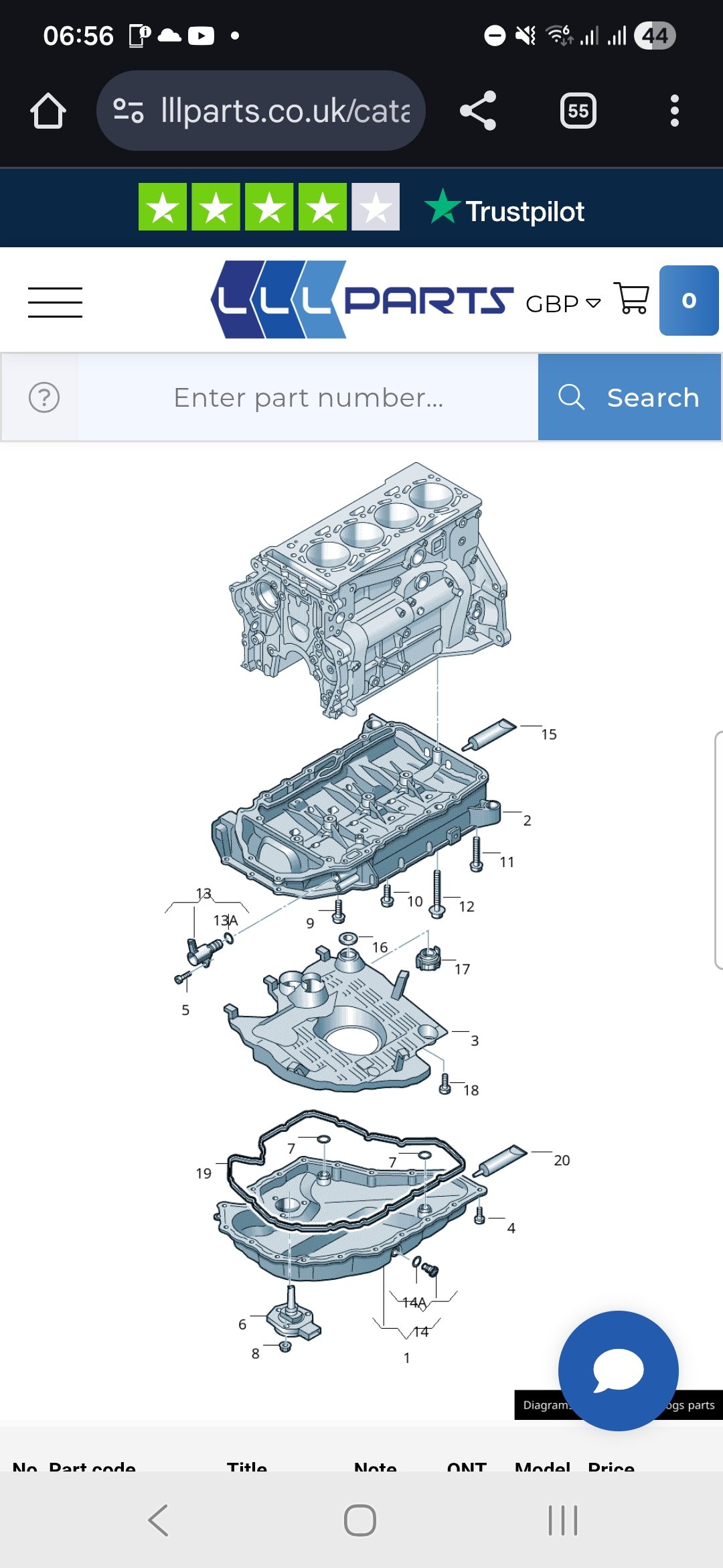

Mostly. But the oil level install is rtv, no gasket. See picture. The N028.... are o rings sited internally in the sump i think where it fits and locates to the upper sump. I didn't replace those, but not a bad idea. Elring sump gasket is 398.260. Edit. Actually, reviewing my photos i've no idea where those 2x o rings go. Maybe they actually fit up under the upper sump, and the diagran is wrong. It doesnt match up to my sump!! See pic..
