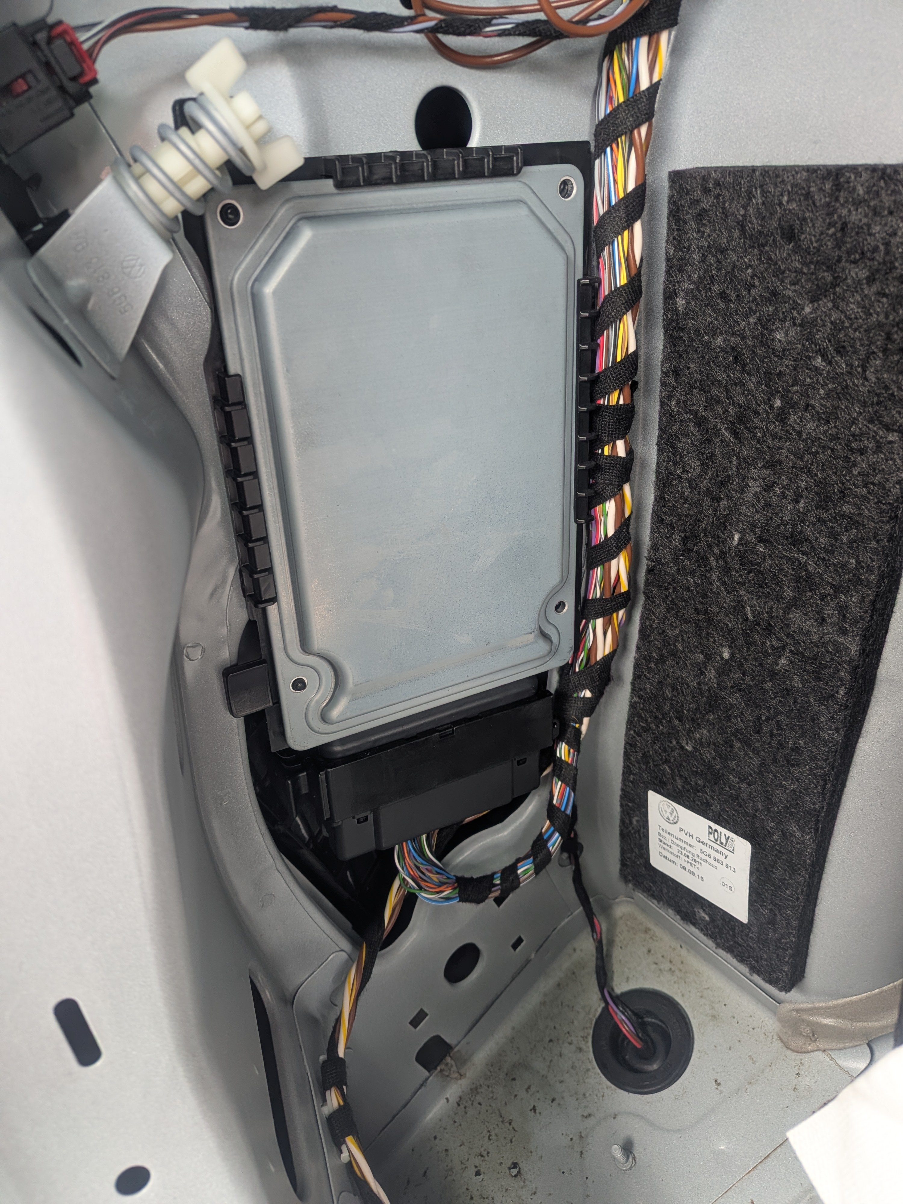

Cheers dv, I'm guessing I can get away with not unplugging the battery (not keyless)? -

Hi All, I've got the dreaded boot leak and pretty sure it's the slam vents behind the bumper. Trying to get to them from the interior rather than taking bumper off. On the passenger side there is this unit blocking my access to the vent. Guessing it's something to do with adaptive suspension? (don't know if there's one on the drivers side as I haven't opened that side up yet). Can anyone explain how I go about remove/disconnect it? There is a sort of clip on the bottom which I've tried compressing/pressing open but it's not having any of it. Also the entire frame appears fixed to something somewhat losely but didn't want to risk snapping anything. Thanks

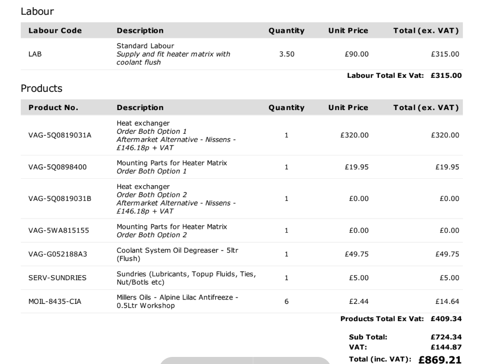

that's what I was thinking even though I'm not a mechanical person - if there was something blocking the flow of the matrix then I would have thought there'd be very little if any heat at all? Yeah I had a diagnostic done, as well as a chat with the mechanic he wrote: (This was an independent VAG specialist btw) Yeah I tried the recalibration thing a few times but it didn't seem to improve anything -

Hi, Got a problem with the heater matrix on my 2015 mk7. There is no hot air blowing out of any of the vents on the drivers side (RHD car) Heater controls/flaps etc all visually confirmed as working. Calibration all good/no errors with the control module VCDS etc. There's no overheating or coolant issues. There is history of a suspected silica bag bursting a few years ago and I had the engine flushed with new coolant added and a new bagless header tank. Garage reckons it is a blocked heater matrix - I am slightly sceptical unless it just happens to be part of the heater matrix blocked which sits behind drivers side control flaps? I have been quoted £724 + VAT / £869inc for new matrix and full flush by an independent VAG specialist. THey have given me 2 options (nissens or some other OEM matrix?) - both at same price. Does this seem reasonable to you folks? I'm guessing most of the labour is the engine flush as the matrix is fairly accessible. Would appreciate your knowledgable opinions! Thanks EDIT - forgot to ask, is it worth getting anything else done at the same time like water pump? Car's only done 20k so may not need it but want to pre-empt it if possible.
I've been quoted for blocked heater matrix replacement/coolant flush etc for £800. If it was blocked matrix I'd have thought I'd get no/very little heat at all, but I've got full temperature range (by feel anyway) on passenger side... 🤔
