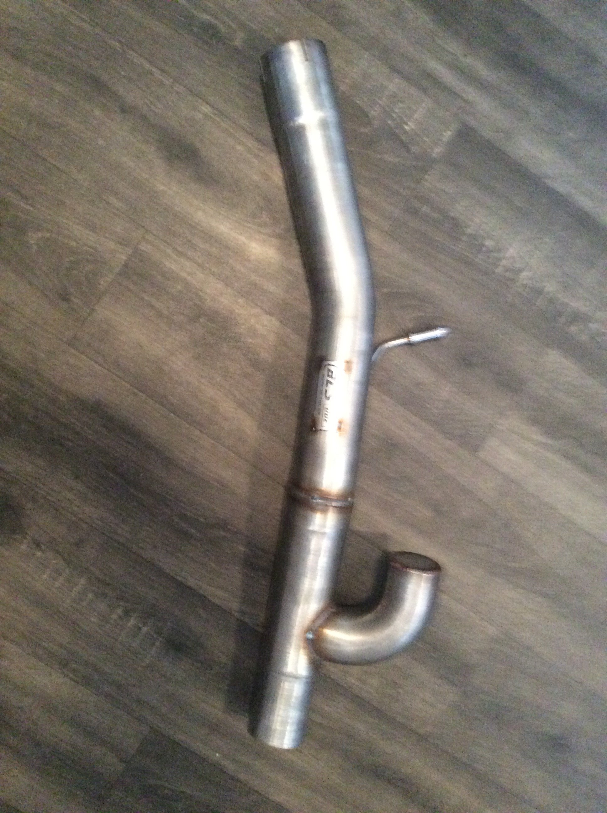

  2. BCS res delete has just been delivered. Will be fitting ASAP. Nige at Powervalve is a really great guy to deal with.

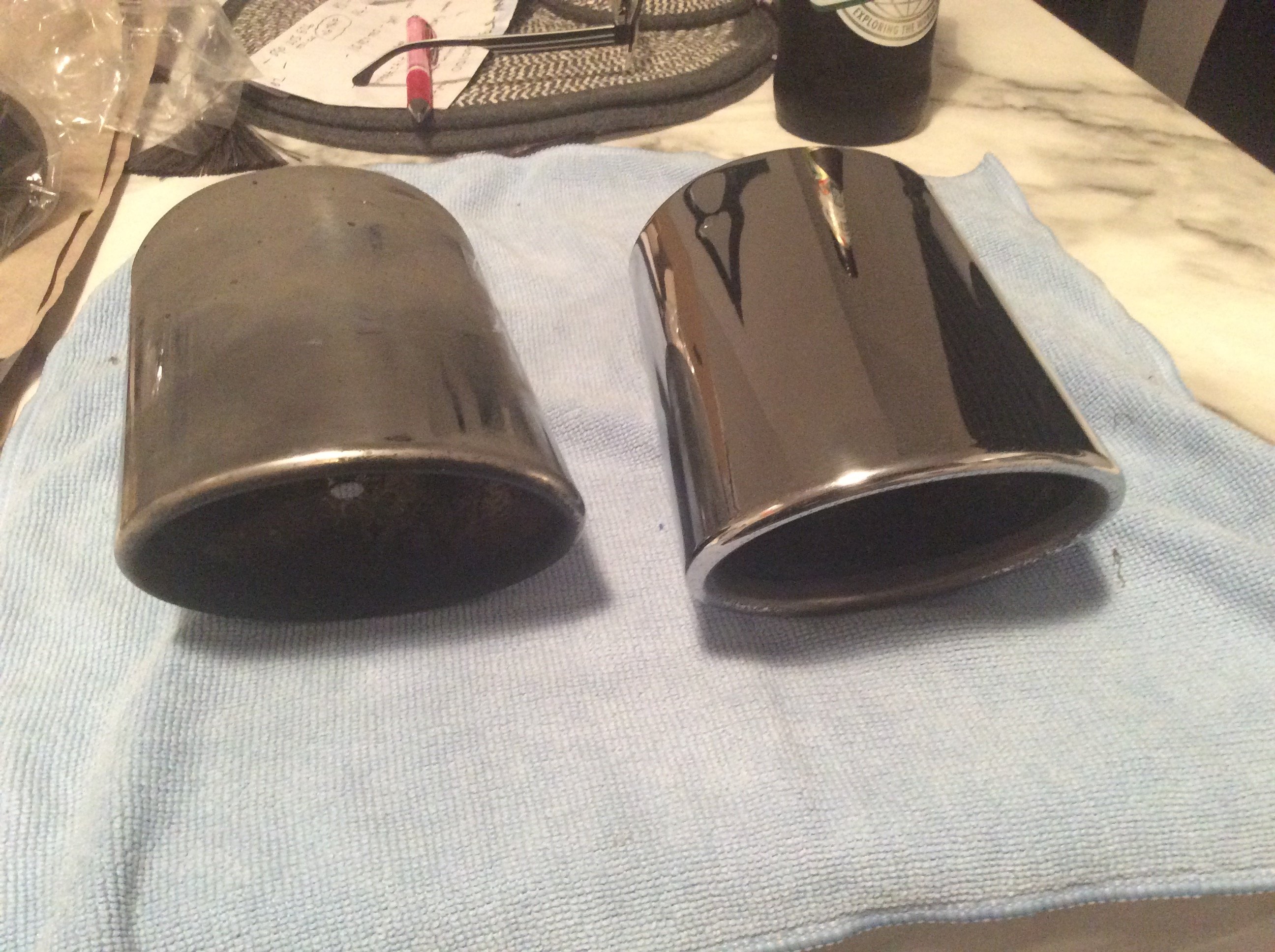

  7. Removed my exhaust tips today & cleaned them up with fine wire wool & autosol metal polish. They’re pitted around the outer edges but I’m quite pleased with them. Treated them to a ceramic coating which I already had lying about hoping that it’ll make them easier to clean in future. Probably turn to tar as soon as some heat goes through em, I’ll have to wait & see.

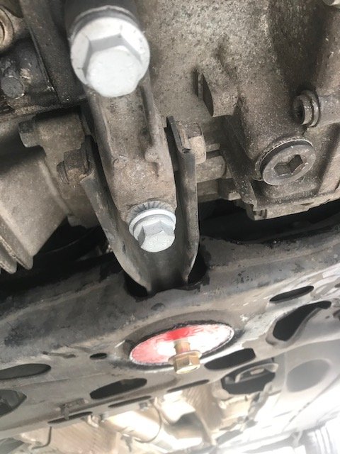

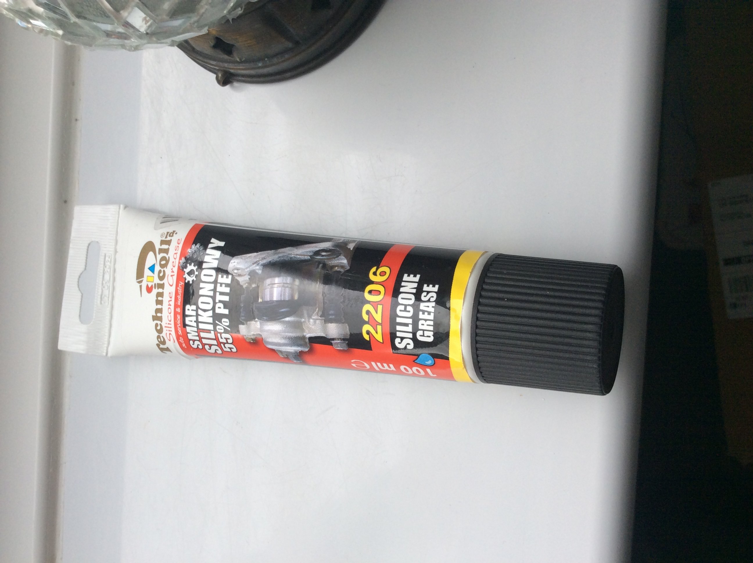

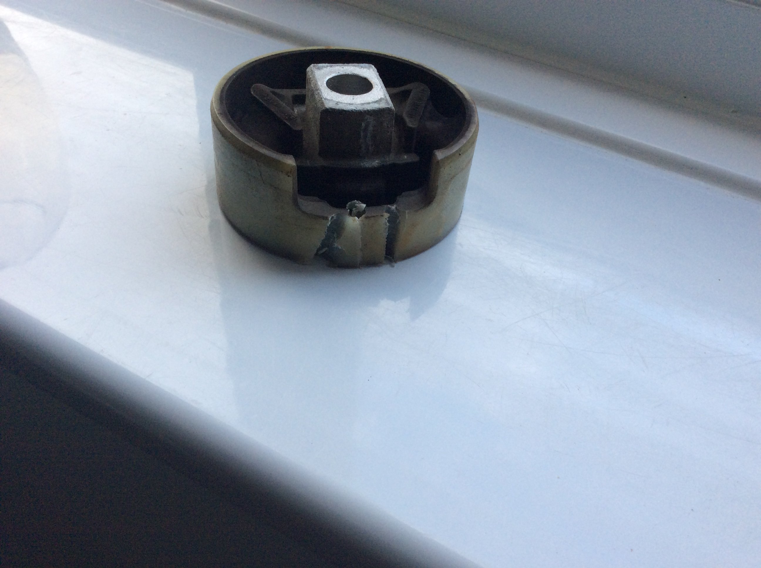

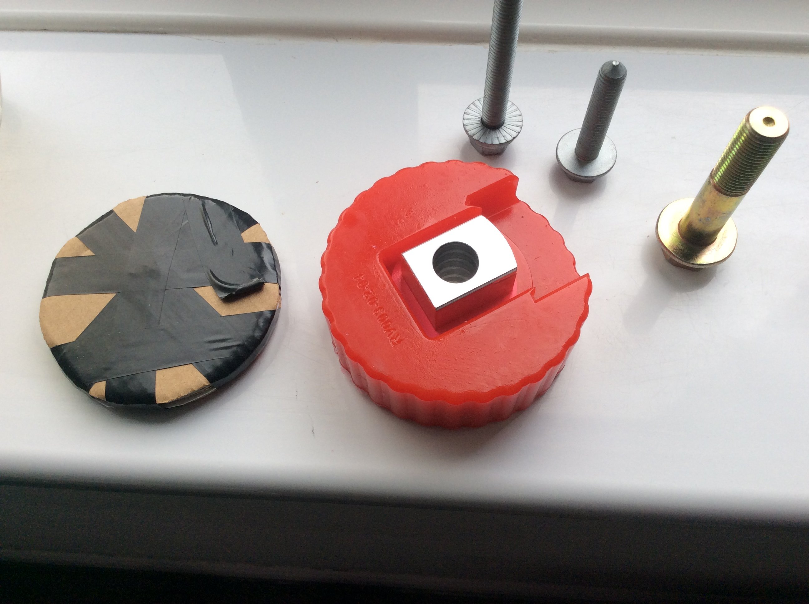

  13. Fitted Revo lower torque bush. Only took an hour which included jacking up the car. I didn’t buy in installation kit as it only helps to insert it, instead I used the bush as a template on the cardboard box that the bush came in & taped it together & stuck it on top of my trolley jack. Used plenty of silicone/ptfe grease ( polyflex use something similar ) & it went straight in. Torqued it up & boom. Hardly any NVH, can feel it a little with air con on but liveable.
