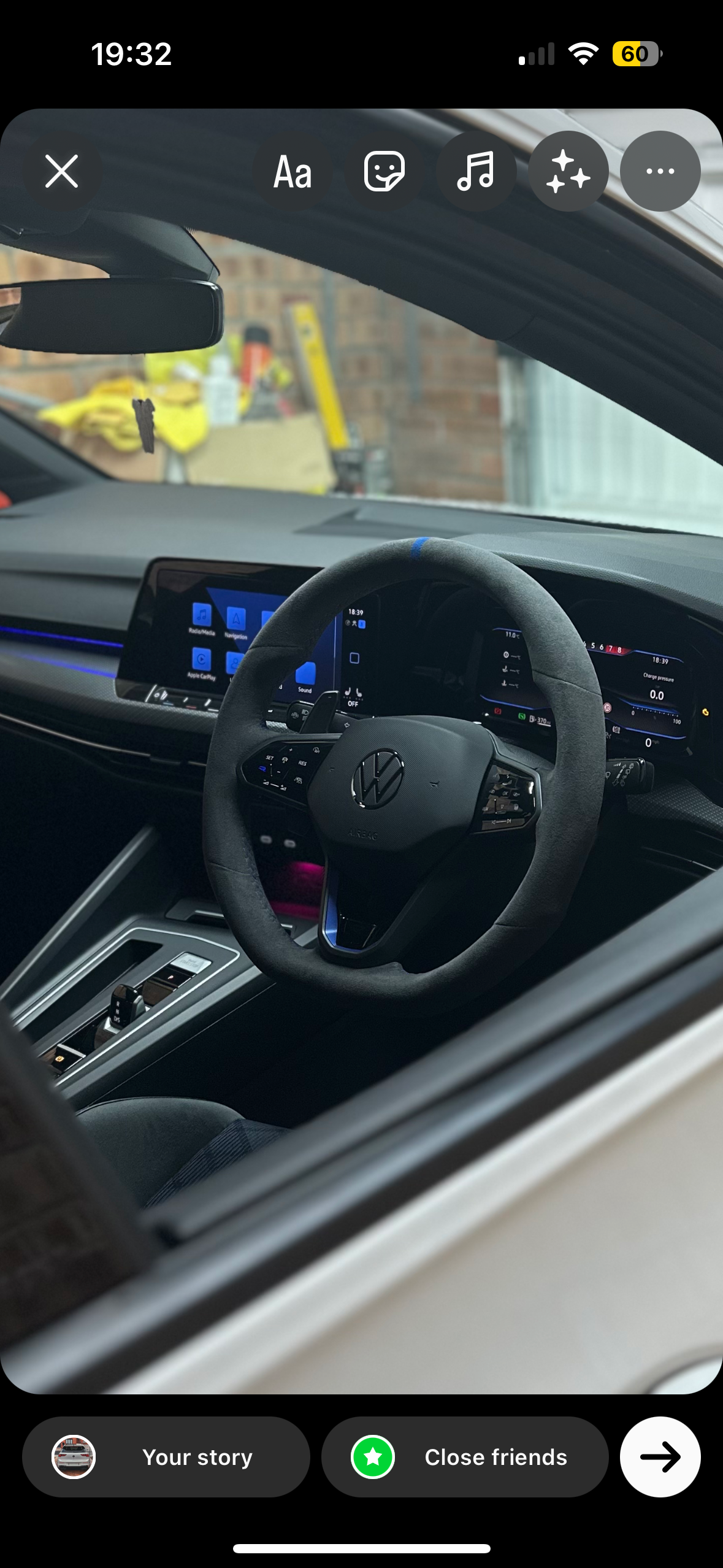

Thanks! That is something to think about with all the problems the steering wheels have caused. I seem to get the sos once every couple of months or so even with the new module out the replacement wheel. If you speak with control customs they actually know the problem and will eliminate it completely but it’s more expensive.

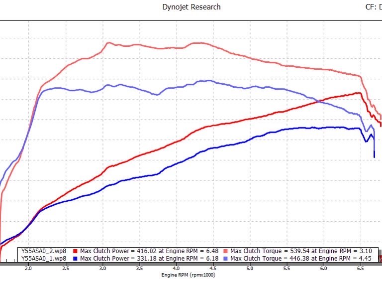

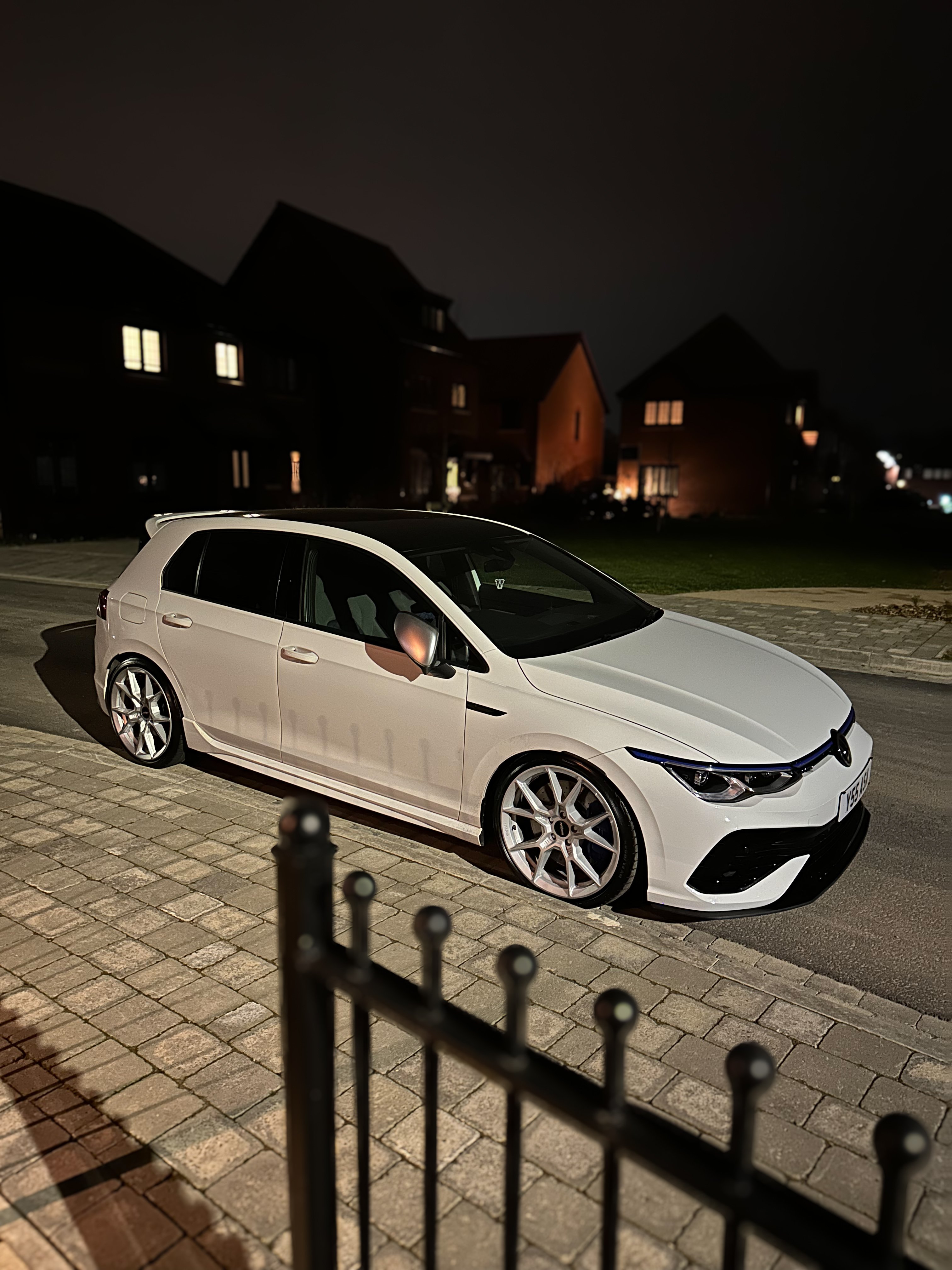

Oh nice chunky new rubber, my estorils are tooked away in the garage. The RL R600 and turbo inlet give a little boost in stock like 10/15bhp but even more when tuned. Definitely something I’d recommend. The car dyno’d at 331bhp, 446nm stock and 416bhp, 540nm stage 1. If you also add an intercooler you can jump up another 30bhp with stage 1+ but I’m happy where it is. The car feels so much more alive especially in the rear with the magna diff. It likes to kick the rear end out especially in damp conditions. The Rotiform wheels are 8.5 x 19 ET45. The perfect fitment for filling the arches out a little. Tyres are 235 35 19. I love the steering wheel, highly recommend speaking to control customs with the design you’re after. I picked up a used wheel off ebay and had that recovered then swapped the parts over. I still have my brand new replacement vw wheel in the garage.

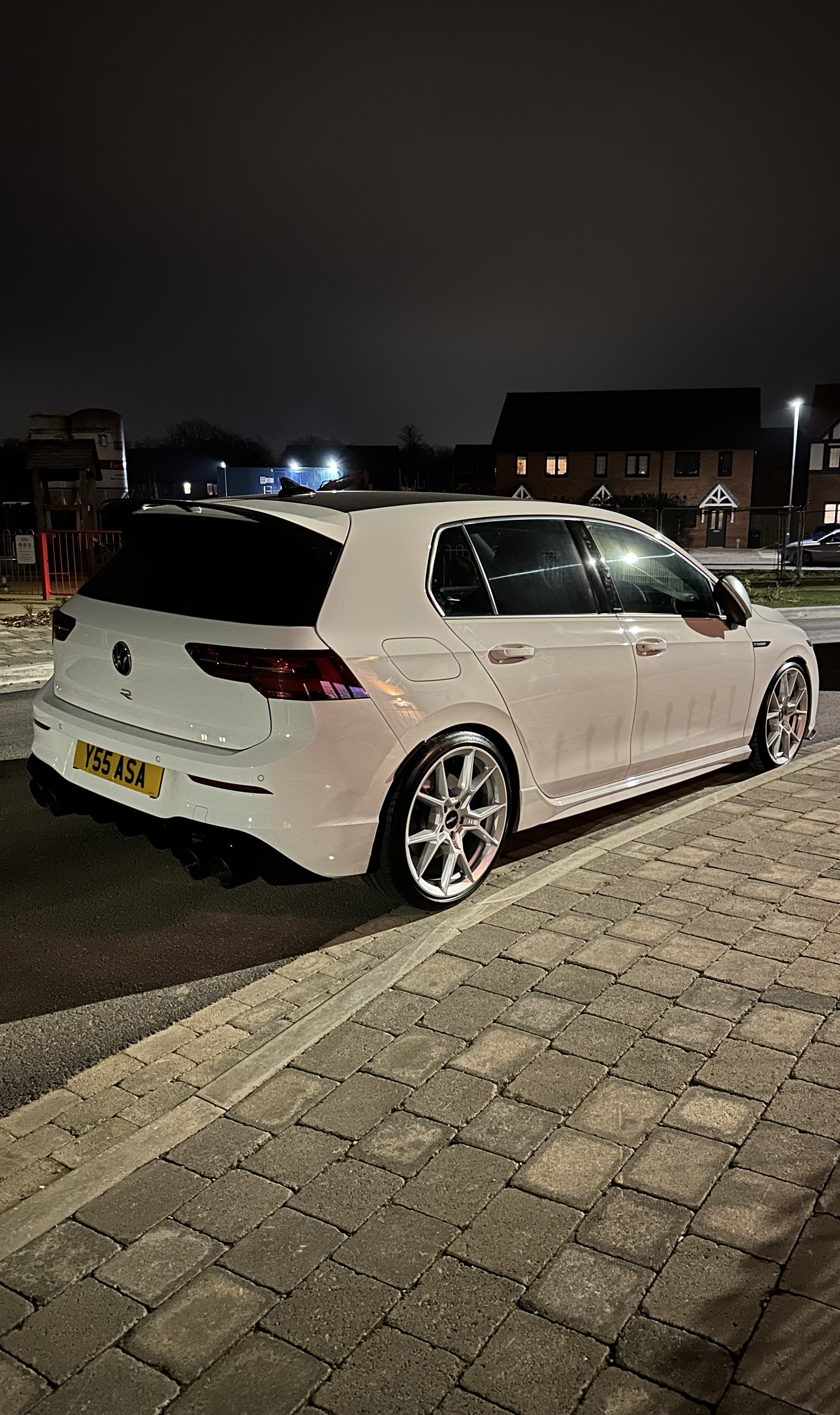

Thanks! Most mods aren’t visible 😀 Racingline R600 and turbo elbow, racingline stage 1 ecu & tcu with PDM controller. Maxton rear diffuser, maxton street pro front splitter, Milltek GPF back with carbon tips, control customs steering wheel in full Alcantara, racingline bonnet strut and fuel cap, racingline springs, gloss black wrapped roof, Rotiform KPR wheels, genuine Performance pack spoiler. Think thats pretty much it 😅

Been a while since I posted but thought I’d share a few little mods over my 18 months of ownership. Still loving it 🤩

Amazing figures and car looks spot on. Do you have any crashing issues with pot holes on that combination? I'm looking into it now as a cheaper option than the KW dcc coilovers. I currently have the racingline springs with my stock dcc dampers which feel great until you hit a sunken grid or pot hole and they bottom out. I have just had the bump stops shortened which seems to have helped but its too early to know for sure.
