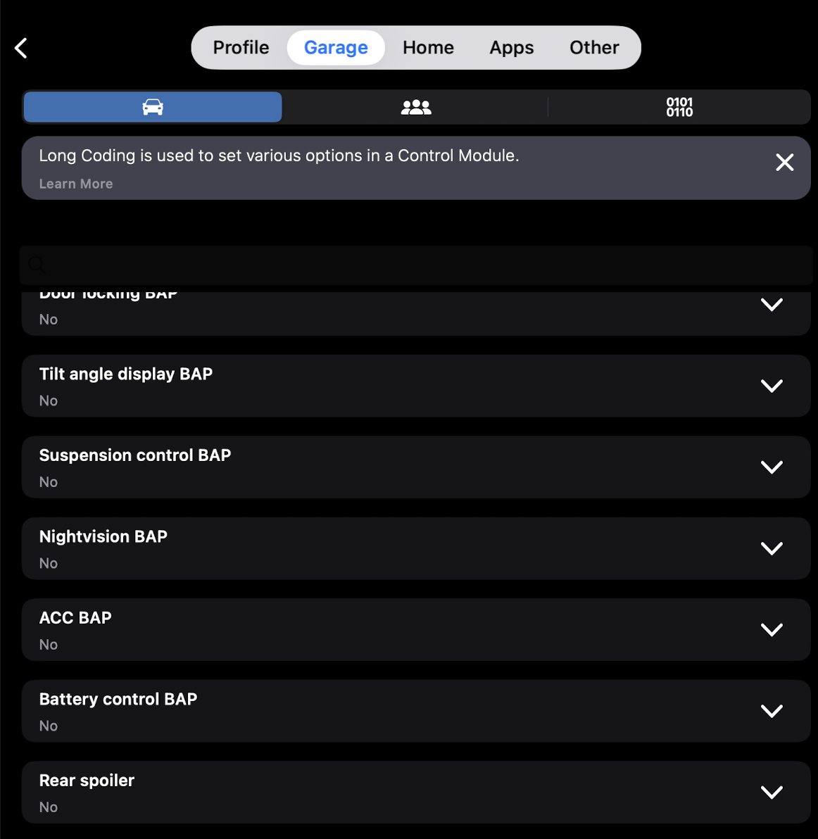

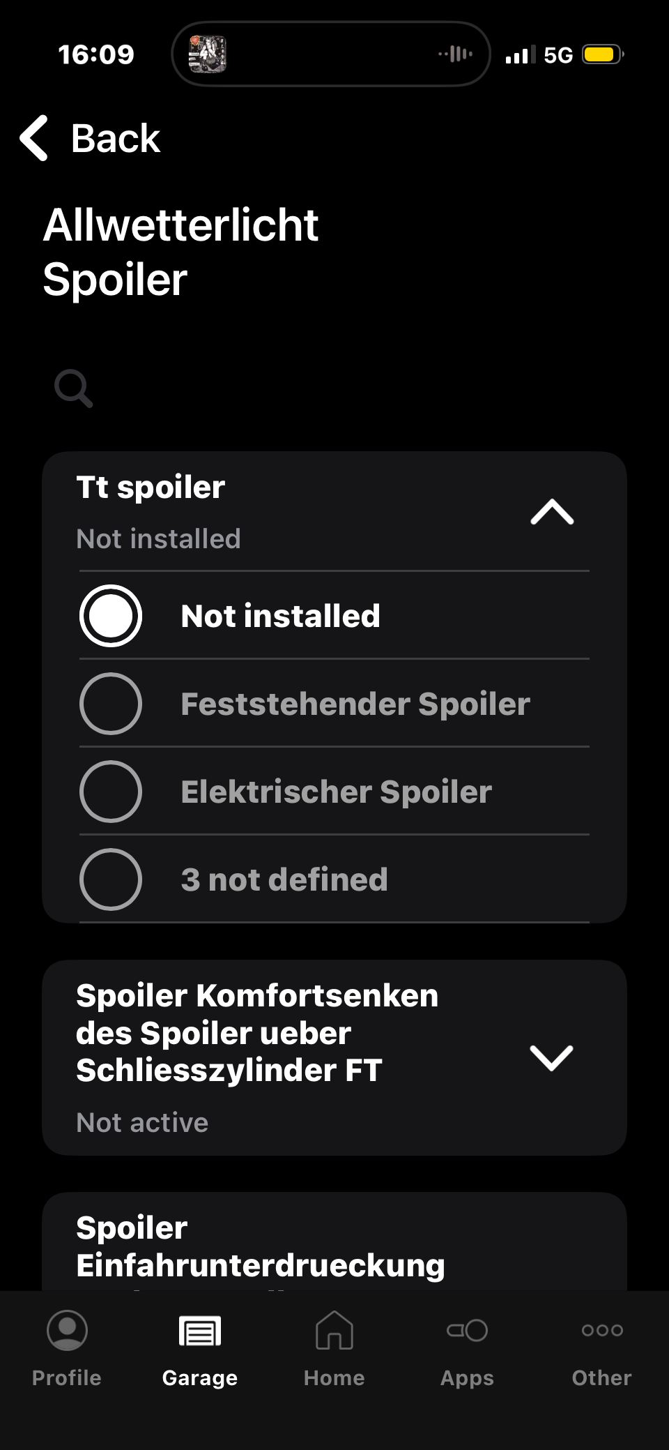

Hi Don in OBD11 under long coding for 17 - Dashboard I only have the option of either 'yes' or 'no' for spoiler so there was no need for selecting a bit or byte thankfully which made my life a little easier. Under 09 - central electronics I selected not installed These settings seems to have worked perfectly and I have no error codes on the cars dash after disconnecting the electric spoiler motor. I re -scanned after this and have no error codes there either so I assume everything went well Thanks for all you help
@dv52 Thanks for the prompt reply as always. I'll be using OBD11 Pro. I've done a little more research and I think there won't be a requirement for any "Bit' or 'Byte' coding. From what I can tell now, between your initial reply and a little more playing with the OBD11 App I just need to select the either the yes or no option available to me under 'spoiler'
Hi @dv52 So after waiting many, many months(it feels like years!) the paintwork for the spoiler has finally been finished (don't ask why its taken so long 🥴) and I'm ready to install it this weekend. I'm not only nervous about the actual fitting of the spoiler but I'm super nervous about the coding I need to do. Although I've ventured into the Adaptions menu for my old Golf R to change some if the brake settings, I've never undertaken any 'Bit or`Byte" modifications on any of my cars and am not 100% sure how to start. Would you be able to give me a rough idiots guide on how to get started please? Any help would be greatly appreciated Cheers Steve.

Hi Don You are an absolute STAR! I knew you would be able to offer some advice. Thank You!!!!!!

I have just purchased a 2022 Mk3 Audi TTRS to replace the Golf R. It was almost the perfect car but the original owner specced the car with an electric rear spoiler rather than the fixed spoiler. I have managed to find a used but complete OE Audi fixed spoiler from a similar specced car that I intend to fit to my new car. The electric spoiler is attached to a large metal base which is a slightly different metal base to the fixed spoiler so that metal base can be attached to the bodywork for extra strength. As such, I need to disconnect the spoiler motor and its' metal base to swap in the fixed spoiler metal base. If I simply disconnect the spoiler motor an error code will appear on the dash and the ESP will be permanently engaged. There is an option in OBD11 (Control Units, 09 Central Electrics, Adaptation, Allwetterlicht Spoiler, TT Spoiler and then change the option from Elektrischer Spoiler To Feststehender Spoiler) to change the coding from electronic spoiler to fixed spoiler which stops the electric spoiler from being operated / deployed, but I am getting differing advice as to whether an error code will still be generated when the spoiler motor is disconnected. A member of the TT Forum has stated the following coding stopped any error being displayed when he disconnected his spoiler motor on both his and another members car. The first part in 9 - Central Electric seems straight forward but know one can seem to find anything relating to the rear spoiler (the 2nd part) in 17 - Dashboard. The OP sates the following; "Hey Guys to upload everyone about the spoiler thing from electric to fix So We spent about 3h with Stanly and finally fixed it So for everyone going on a fix spoiler: UNPLUG THE ELECTRICAL SPOILER ONLY AFTER HAVING THE SPOILER INSIDE (NOT EXTENDED) AND AFTER CODING THIS 2 MODULES WITH ODB ELEVEN PRO: 9 central electric: long coding find spoiler and code it (there is 4 possible options) as UNMOUNT 17 DASHBOARD: adaptation or long coding don't remember now find spoiler (2possible options YES or NO): NO Go back in 9 central election electric live data find spoiler and verify that spoiler status is: spoiler not mounted Then turn off engine, turn on engine verify that when pressing the spoiler button nothing happen" Turn off again the car and now you can unplug the spoiler Any coding gurus on here that have any ideas / knowledge of this or suggestions on where / how I can find the required coding in 17 - Dashboard?
