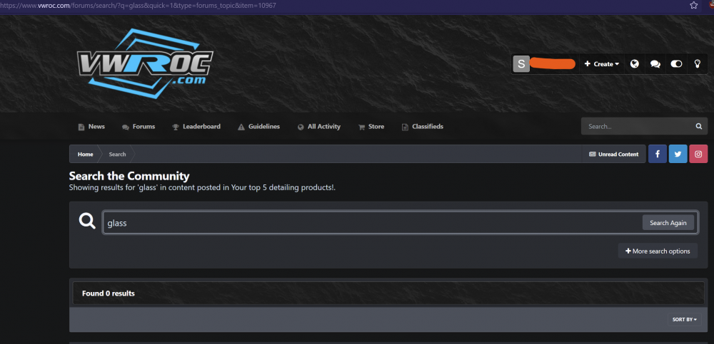

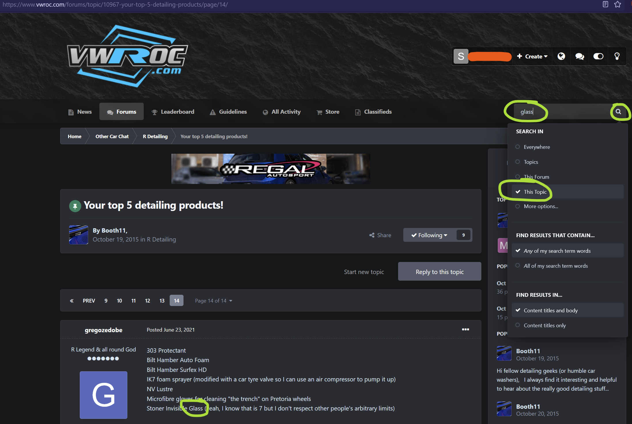

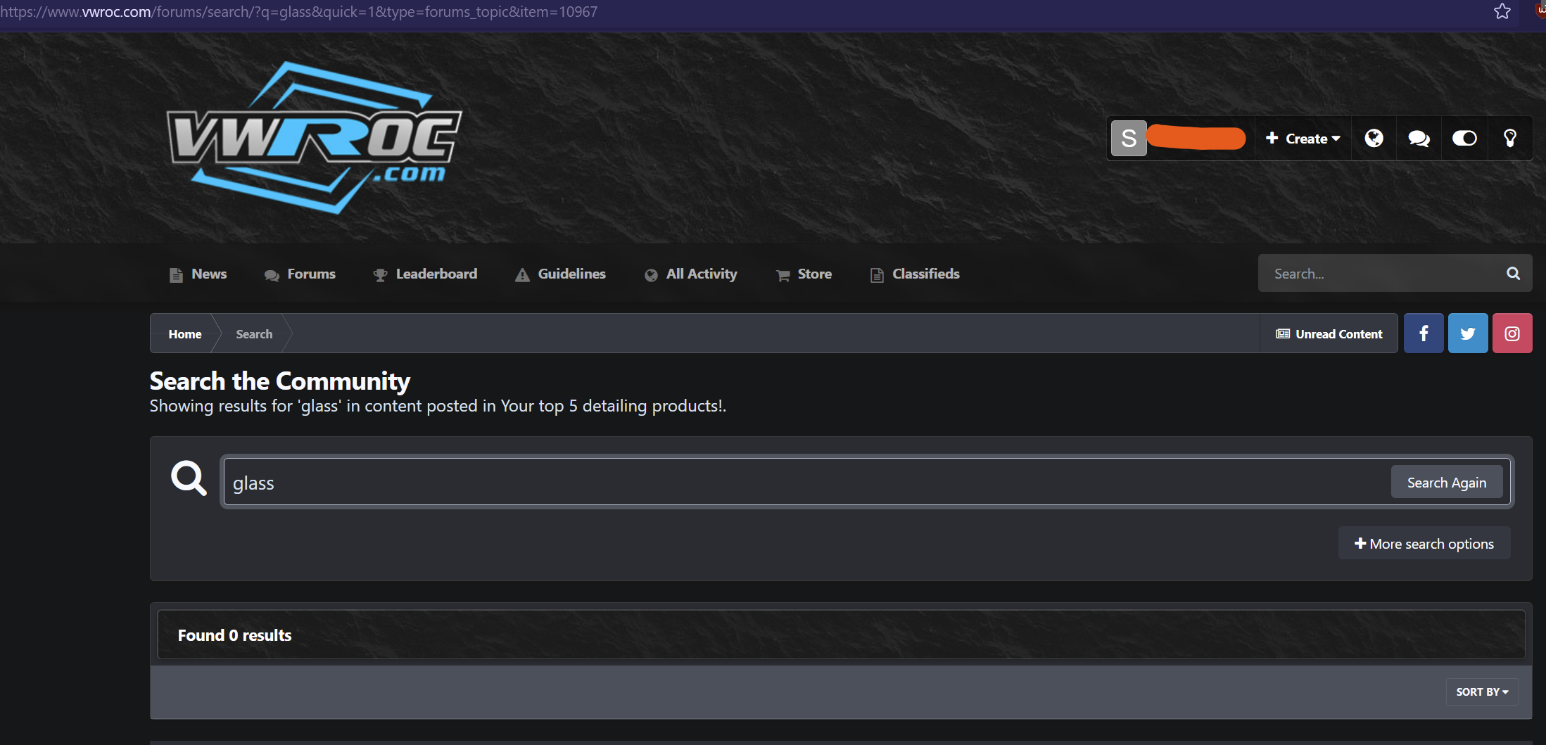

See screenshots - am I missing / not doing something obvious? (trying to search for the current recommendations for best internal glass cleaner)
