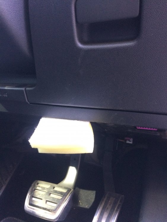

Have had an annoying rattle from the dashboard of my 16 plate R estate for several months. Started as intermittant and then became a permanent fixture. Exceptionally irritating and really spoiling the car. Couldn’t track it down. Booked it into the dealer for investigation which would have involved removal of dashboard and rummaging around. Came across this thread and a few others suggesting the driver’s knee airbag was the culprit. Had a feel around under the steering column and located the airbag (rectangular shaped block with a slightly squishy surface). Pressing firmly on it (or wedging my fingers in the gap between the airbag and the surround) blissfully stopped the rattle. A more workable temporary fix was to wedge a washing up sponge into the same gap - see pic. This made do for a 1,000 mile round trip before the airbag was replaced free of charge by VW (even though the car was by this time 3 months over 3 years old so technically outside warranty). Impressed with the customer service! Posting this in case it helps anyone else with diagnosis, the temp sponge fix, or encouraging VW to address it out of warranty. -
