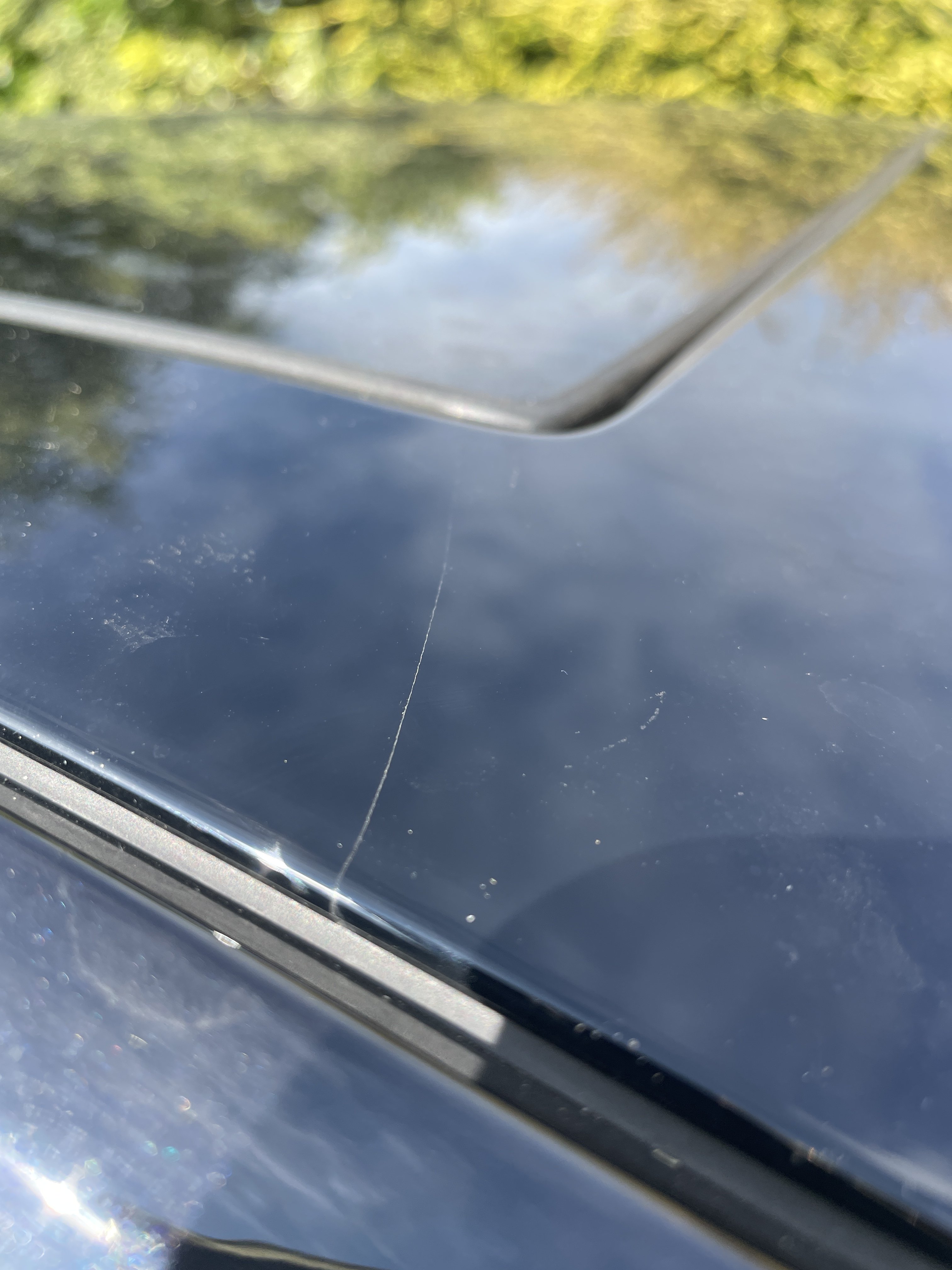

I had this exact problem on my 2019 R and VW recognised it as a defect and it was repaired under warranty - mine was VW used approved l. My car was 4 years old at the time. The dealer didn’t do the work, they got an expert in lol which was a windscreen fitter who they worked with. It was a nightmare to get it to that point though and I had lots of battles. It’s about a £1500 job and it cracks because of the adhesive used that does not flex with the car so cracked. -

Now I have the 8v I don’t have this issue, it’s been replaced with the ‘does the sunroof button fancy working today ?’ Most of the time it does but sometimes it just says nope
It’s a recognised vw manufacturing defect not a warranty claim. That’s the problem the dealer is treating it as a used warranty claim and not as a manufacturing defect. I didn’t pay a penny and that was 12 months ago on a 2019 7.5 used approved
I would speak to vw directly particularly their warranty dept, don’t worry about the initial rejection from the call centre agent, you need to escalate to speak to a technician in their claims who will be far more sensible. Dealers don’t fight for you, they simply submit to warranty and the agent who looks at it will look for anything in the description from the dealer to reject the claim. Vw fund the part and the dealer is responsible for the 3.5 hours of labour for the glass fitter to change it and wait for it to bond. I have pictures of mine before it was fixed

If it was a stone chip there would be an impact mark which mine didn’t have
