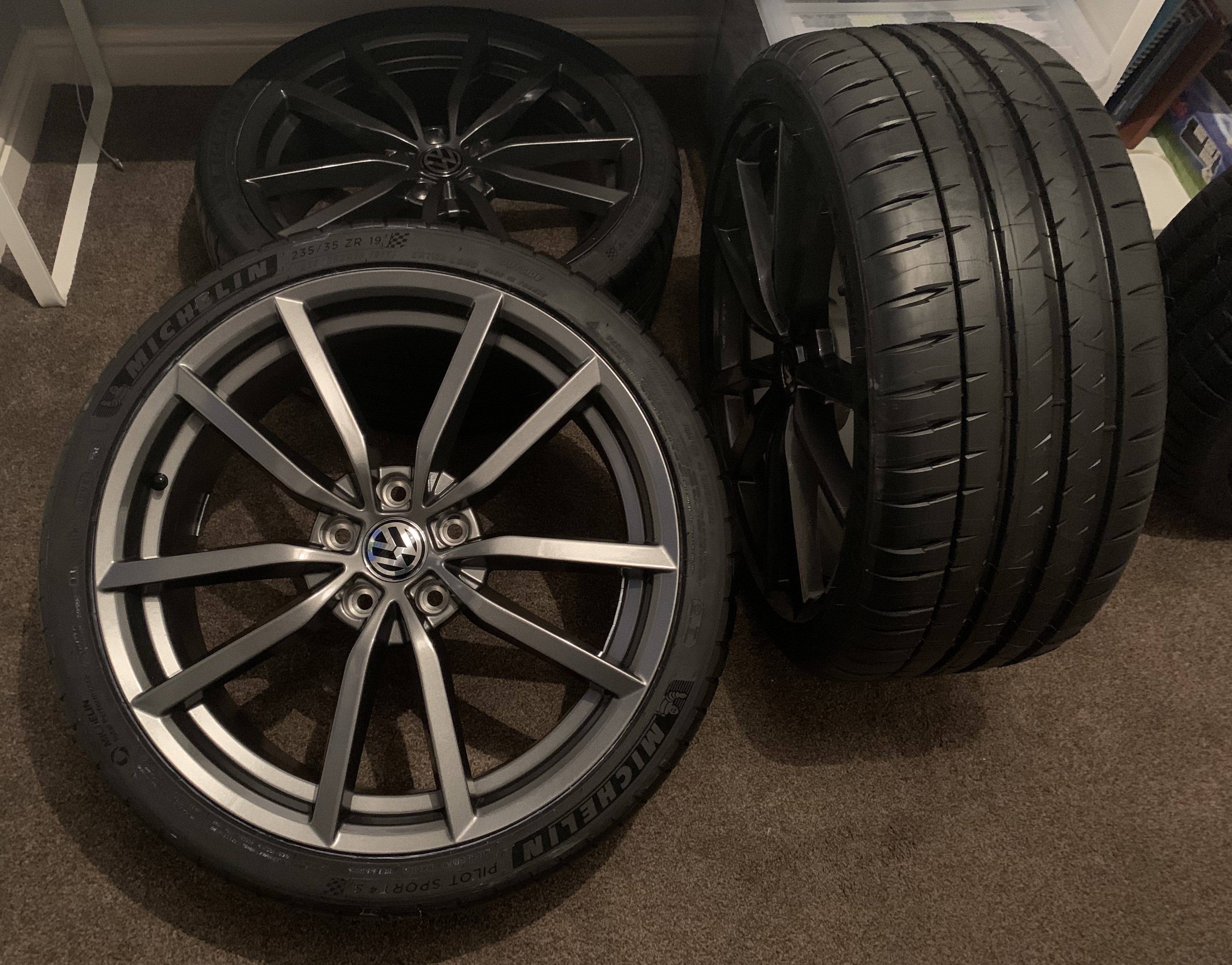

Looks like I did fit the tyres first [emoji3] Looking through my photos around the time I bought my CM reps, found this photo of my wheels curing in a spare room. http://vwroc.s3.eu-west-2.amazonaws.com/monthly_2021_07/3779521F-F2B7-4C94-8E8B-FEA291AC98E1.thumb.jpeg.903fe83b245451c002567ab087af386f.jpeg
I did mine before tyres were fitted, purely so I could get them fitted to the car at the same time as fitting. Sent from my iPhone using Tapatalk
