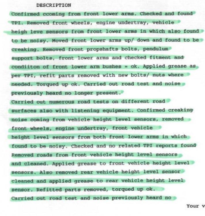

Creaky Suspension TPI information needed
AgentFruit replied to TheBlondeFella's topic in VW Golf R MK7 Chat
I’ve had my creaky front suspension fixed and yes there was a TPI. Haven’t managed to find details of the latter but here’s the report from the fix. More on the other thread which is probably easier to follow rather than running two threads on the same subject 😊
