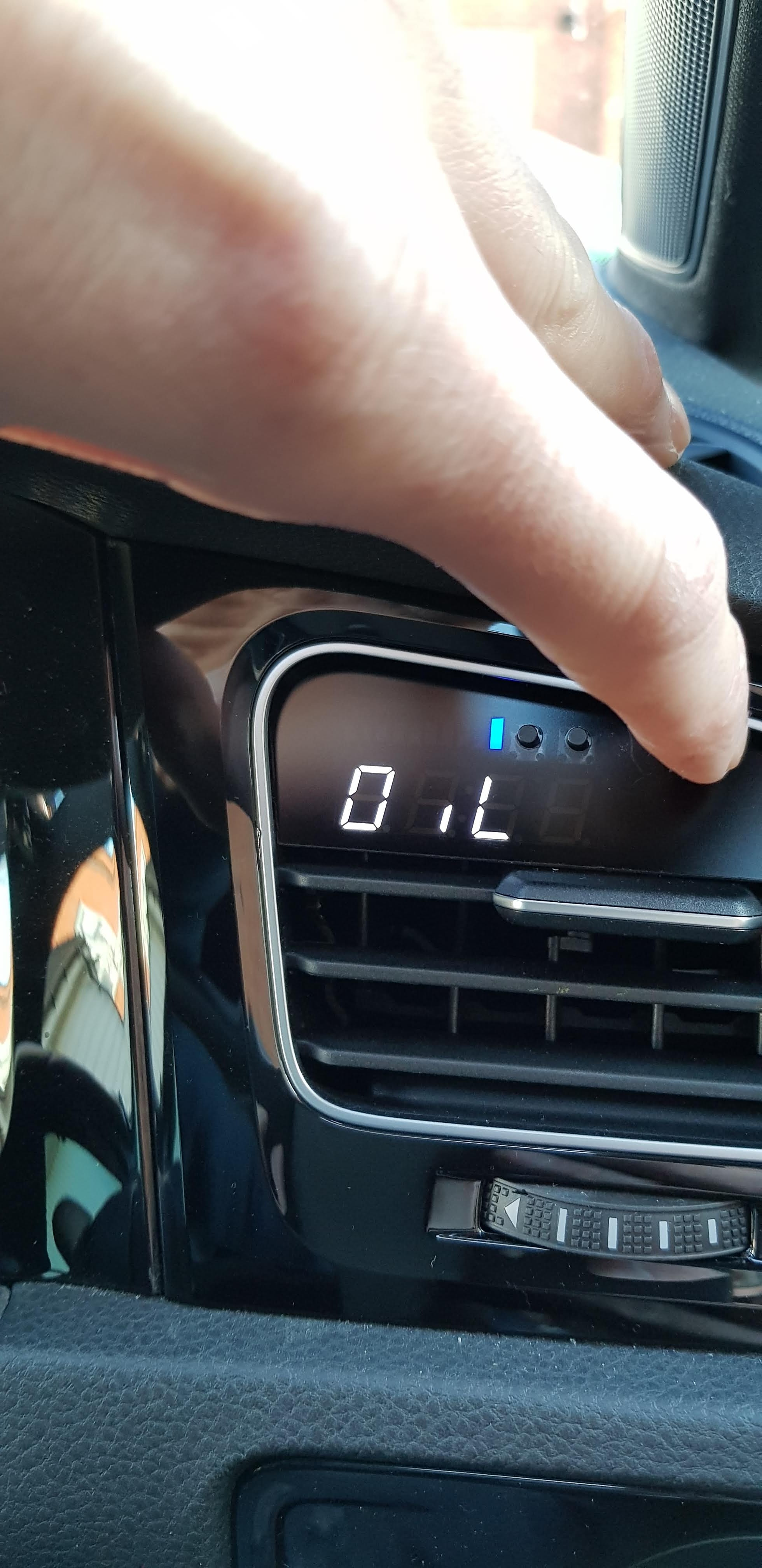

No battery drain to speak of, yes the boost signal is direct from ecu or you can buy an additional attachment and run an actual boost pipe for a direct reading. It's a shame it isn't a little easier to code as would be nice to get gearbox temp and haldex info on it like I can from torque pro, I mainly have mine on oil temp so that I don't push too hard before it's up to around 70°

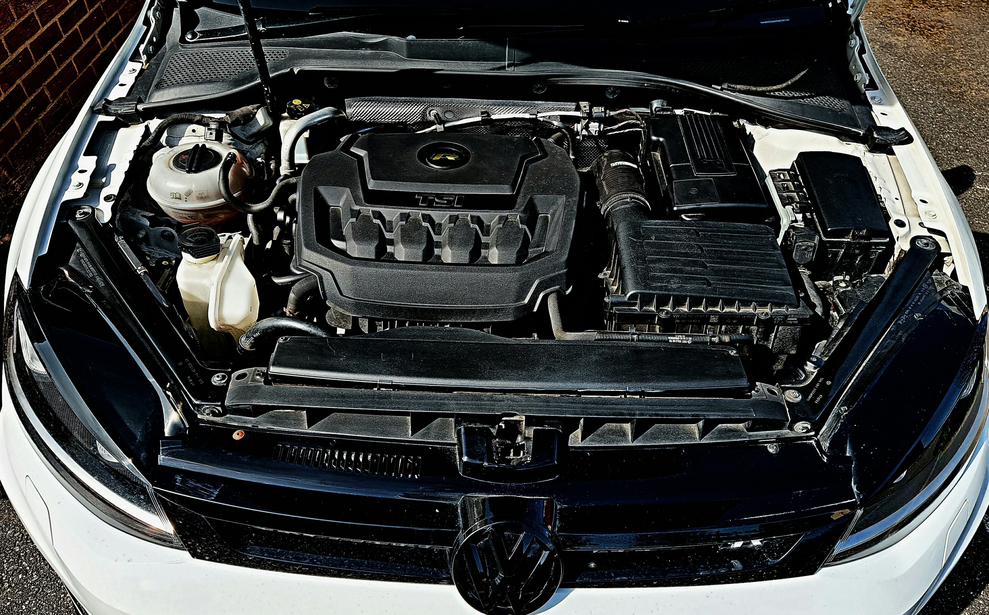

I have standard airbox with blanking plate added and holes drilled (pikey r600) with the usual turbo elbow etc. Running about 400bhp on a high torque tune and no issues with heat soak. I will add an intercooler if I ever upgrade the turbo, and of course I would run a few degrees cooler with an IC but it's not absolutely necessary.
I have a P3 gauge, does lots including oil temp from cold and actual coolant temp not capped at 90. Boost too and if you fit a simple tube through the bulkhead then analogue boost as well.
